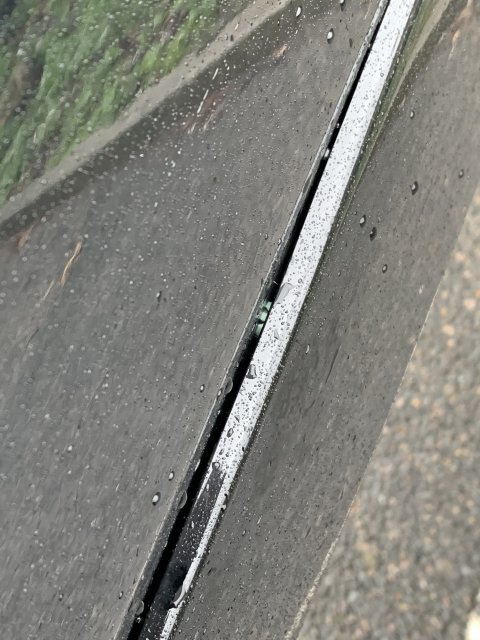

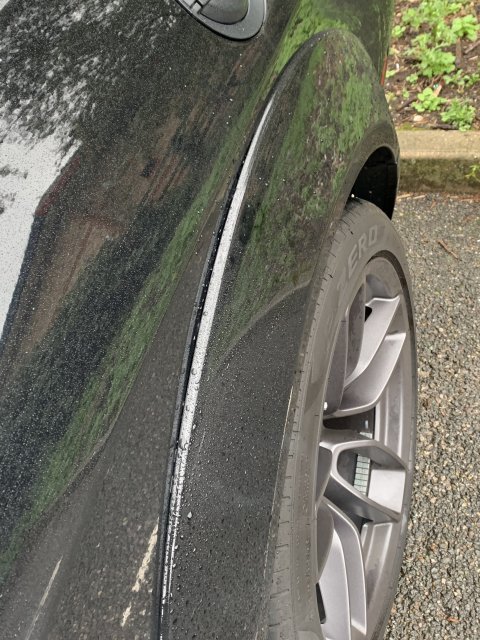

Noticed today one of the rear arch clips has popped off (nothing has hit it).
It was raining so I didn't fiddle with it and wondering what the best technique might be and better to ask before giving it a thump.
Thanks

Thump is appropriate. The rear flares install with clips only.

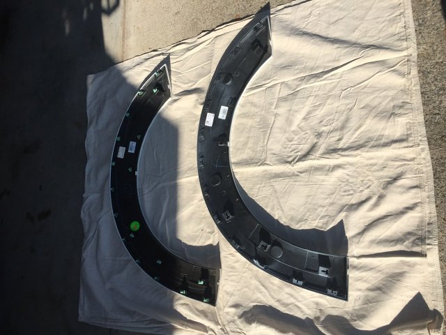

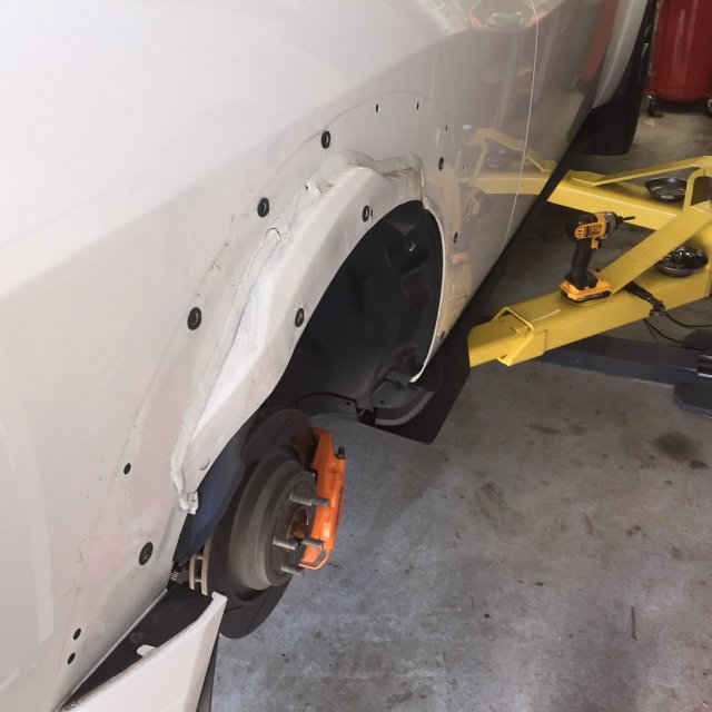

Best pics I have of the rear flares.
CA6292B5-4C0F-43EA-80A7-18567543440B.jpeg 06A4C3C4-DC50-48A5-908B-6D848A0DCBAC.jpeg
That's really helpful thanks very much (y)
