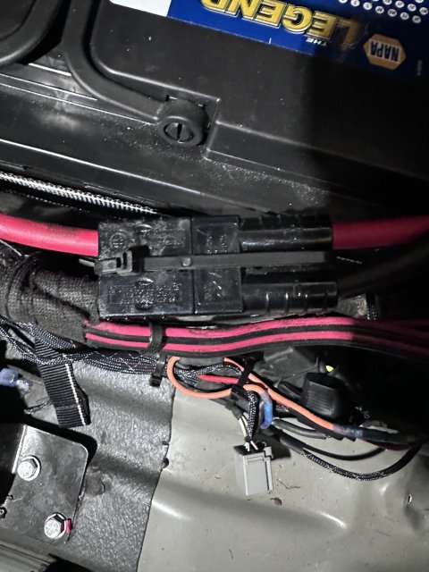

Got it fired up.
easy enough.
the jolt on the car knocked the power plug to the fore fuel bus bar.
it’s now zip tied up.
now she needs a super charger belt
