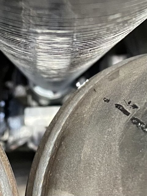

Had the dss carbon fiber driveshaft installed today. My service advisor took this picture. Should I get a smaller muffler?

That's too close for me especially with a high dollar CF which isn't very forgiving with nicks and gouges..

I thought so. I will order smaller diameter mufflers.

Man that seems close. You had that done at the dealer?

Nope. They just installed the driveshaft. Mufflers were on there with a QA1 driveshaft which was not as large. I am going to order the MBRP resonators. They are only 4 inches in diameter.
