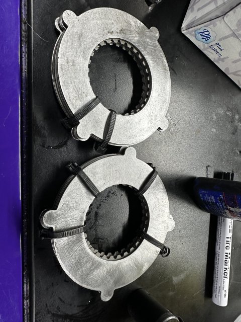

Selling a new set of clutch’s for zf diff
