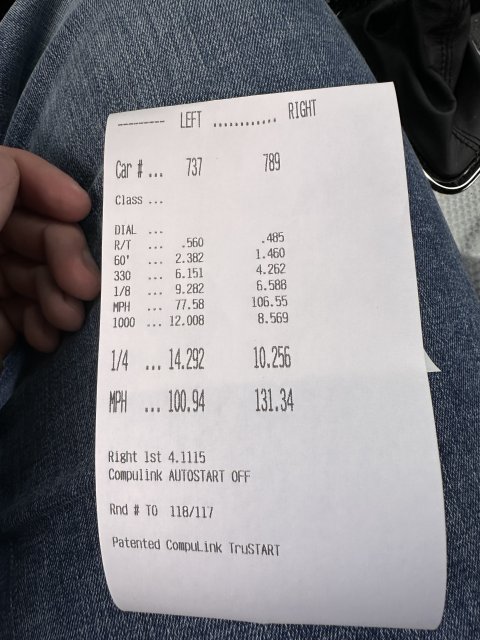

Hopefully doing a few more things by the time it gets cooler out. 9.5 or better is the goal

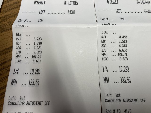

20HCM6 22RENBS2
1.5's in the 60 with LC.
