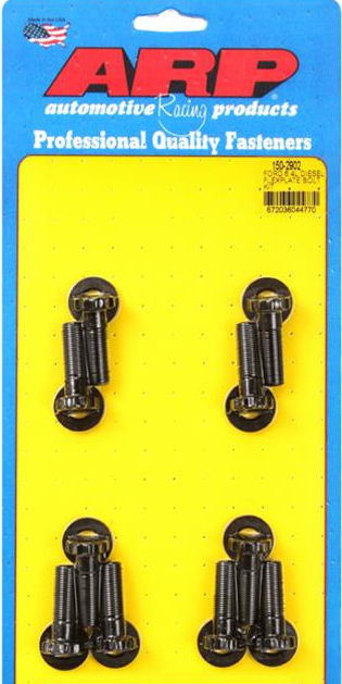

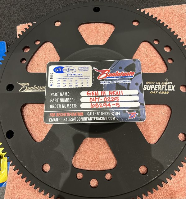

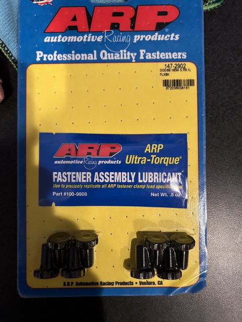

Good pass! 👊. Ok where do I start. Flexplate bolts? What is up with that? I have these waiting with a new Super Duper plate. Thoughts? View attachment 139244 View attachment 139246
Marc,
I think it's because we keep turning up the 60' and just hitting 1.14 sec 60' with a 4200lbs car.
Also, because we have a TH400, we have to use these ARP bolt with our transmission adaptor: https://www.summitracing.com/parts/ARP-150-2902
Plus someone needs to design a better bolt with a shoulder to support these bolts.
