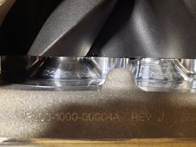

A 3.0? Be curious to know what Rev they’re on now. Please post picture of it, it’s on the back edge on top by rotor discharge. Last one I saw was a Rev J.
is this it?

It is towards the back may have been on the inside. Will be a letter mine was J

same here rev J

Even tho the revision is showing the same I will say I have not really been hearing of issues since September - October
