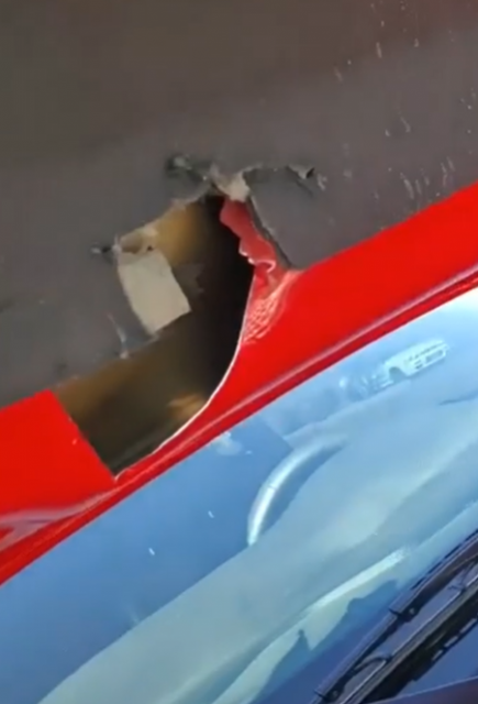

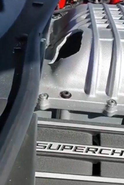

Don't have to worry about this ever happening using the whipple too. Think a few of those new billet plates had machining issues which resulted in catastrophic failure, big thread about that subject on the other forum. There are people on OEM IHI ported/plates with hundreds of passes so i'm sure they can work with proper tuning/maintenance/tolerances. Trying to minimize parts that could break this build.

Hey I know a guy who put a hole in the roof with his stock blower spinning so hard. I think the rotor is still in orbit right now.🤣
I think at this point we need to call Don G.

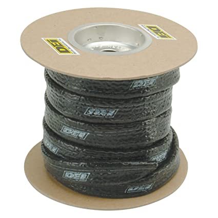

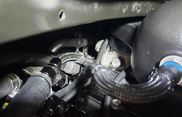

Checking over the car, found three spots making contact on the rear FORE fuel line. Was starting to wear through a little of the braided portion near the bypass valve area/coolant fitting. Very minimal damage but glad caught that early. Adjusted the hose and wrapped fuel hose cut around small contact points - like spacers. 100% looks like shit but can't see it at all unless you get behind the S/C with a flash light.
Will be installing DEI 3000 Fire wrap over the fuel lines to protect against abrasion and heat. Not cheap stuff but gives peace of mind down the road. Very heavy duty and NHRA approved.
How do you guys have the rear lines routed on your whipple cats? Tight fit back there.

over the rear axles and under the car. It’s a crazy tight fit. It helps if you have the rear end out of the car first

Ah still using factory lines feeding the rails. Here is a picture along with a slow-mo video to give a better idea. Hopefully no one else has any damage. One spot was a little too much for comfort. Laying right against the sharp fitting edge.
Not pretty but works (so far) If something looks off let me know.

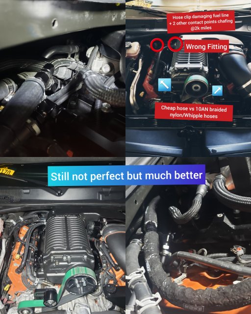

Before vs. After of fuel line. Not 100% yet.

Before vs. After of fuel line. Will let OST adjust to their standards. Not 100% yet.
For sure pays to find the right people
