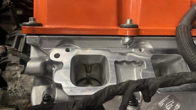

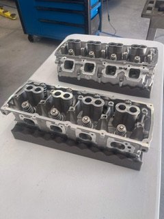

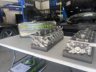

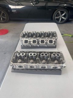

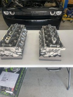

You are looking just at porting. To use their hardware with all new components and the larger intake valves is expensive. Their flow rates for stage 2 are great up to .6 of lift. Other companies brag about super high flow rates at a lift of .7 on the valve. That flow and lift does not happen on our hellcats.
