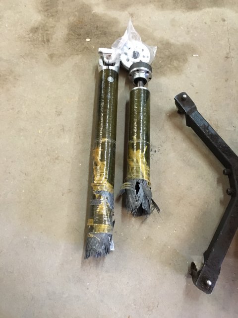

My ‘15 Hellcat did a big 4” unit up before I got my foot to the floor.
That car still uses the prototype 2.5” diameter QA1 fiberglass driveshaft, and the owner loves it.
Enough said.
That's ugly...
That's awful. Glad to seaya up there Bull ster. Thought after today and the threats we had over younder,,, sum of us wood be hunkered down.

Fuckin starting line, it either hooked and busted when something flexed, or it hopped once. Felt like it grabbed so I nailed it and it busted before my foot hit the floor. Wow, these things are torque monsters. So I will just apply the power a bit slower on the road courses.[bash]
They send you a new one? Can't believe it snapped like that
Nope, did not desire another one either.
