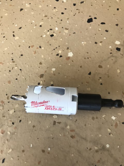

What is a brand new hole cutter?
Lol I don’t know what that is.
Thanks
I was gonna reply about not wanting a "dirty" hole in your car but you guys pretty well covered it with virginity jokes. Lol.
Seriously, I did alot of work on my house years ago when we first moved in. A lot of my cutters and saws are beat. Wasn't gonna use a dull bit to make a cut in an expensive part. Pet peeve of mine is when guys cheap out on something stupid when doing something important. Perfect example: I put a $7400 blower kit on my car from Arrington. Had to change the fuel pump. I google fuel pump replacement, and see guys beating on a drift pin or screwdriver to remove the lock ring on top of the GAS tank. Takes'm repeated efforts and long time, plus ring aint look'n the best afterwards.(Spark danger also?). I just spent $7400, ya think I'm gonna butcher it or risk death to save $50 on correct tool. That shit drives me crazy.

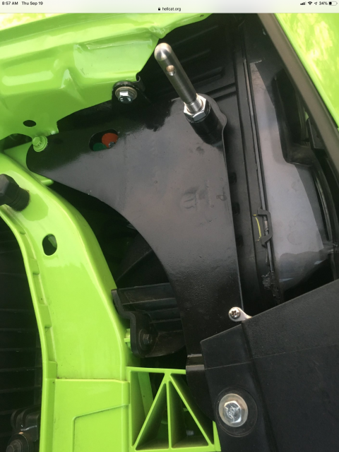

Picture of the modified bracket.
3,289

I see that you replaced that push pin with a real bolt. Good idea if the thing is actually going to be functional at high speed.

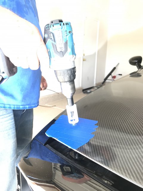

Primetime, I just made plans to buy Marc’s stock hood he had for sale. I thought about a carbon hood but had some of the same questions as you. Just from researching several install threads and videos I’ll start with a new bit for a small pilot hole. Center punch after marking and triple checking measurements. It’s aluminum so a nice slow speed on the drill. I have a set of hole saws I use frequently but with this job I’ll buy a new step bit. Step bits leave a much cleaner circular cut. I think the step bit would be beneficial for cutting into carbon fiber too. Hole saws have large teeth that take a pretty big cut of material. Either way with a new bit you go slow and let the drill do the work. No need to force it. I need to order the Mopar pin kit today and get working.

Thanks goldrunner! I think me and my pops are gonna do the hood pins. He has been a electrician for 30 yrs and has drilled through everything but carbon fiber so we will give it a shot.
Pray for us... lol

He did a nice job. The bolt replaced for the push pin in the front. It seems he added the dog ears on the side of the bracket as well with the new shiny non body painted bolt.
You can see where he sprayed that area with black paint. And added a screw for the safety wire instead of the plastic keeper plug. I like to tig weld, I may have a fun winter job it seems. I have faith in my system, but why not make it real strong!
As well he made the side dog ears and welded them on and bolted them to the side. Also replaced the plastic safety wire pin with a screw. Nice work!

Your in good hands then. Worked for an electrical contractor in college and used many hole saws and step bits. Good luck!

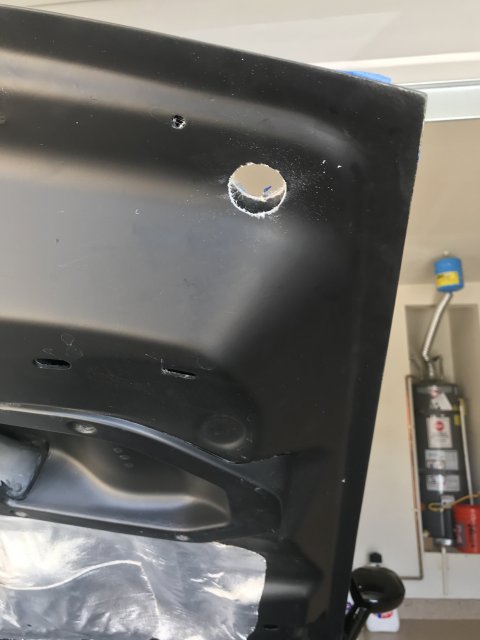

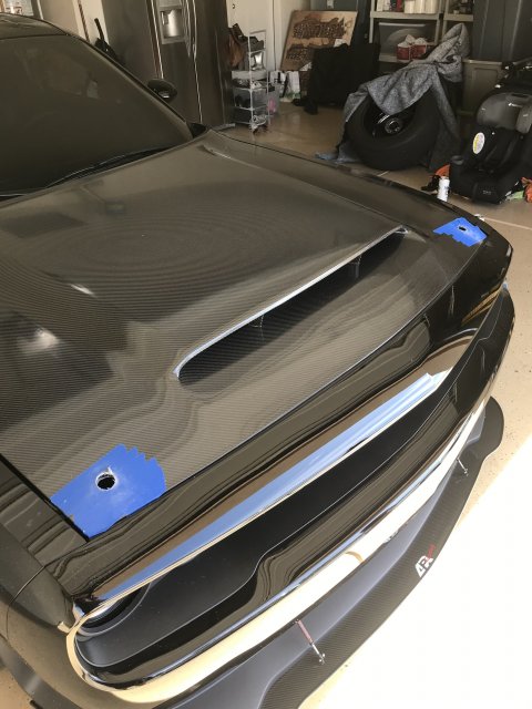

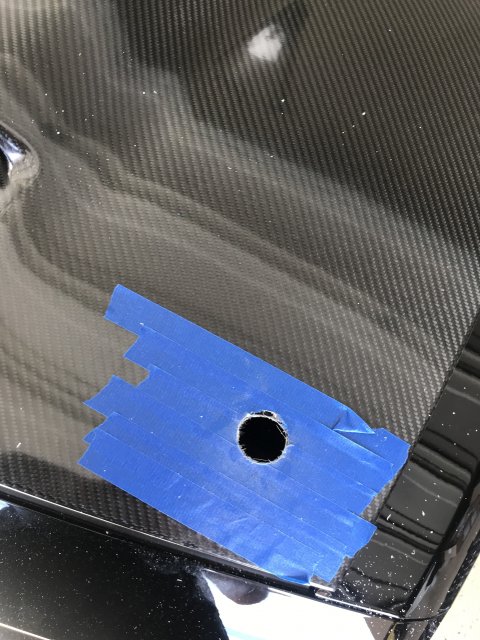

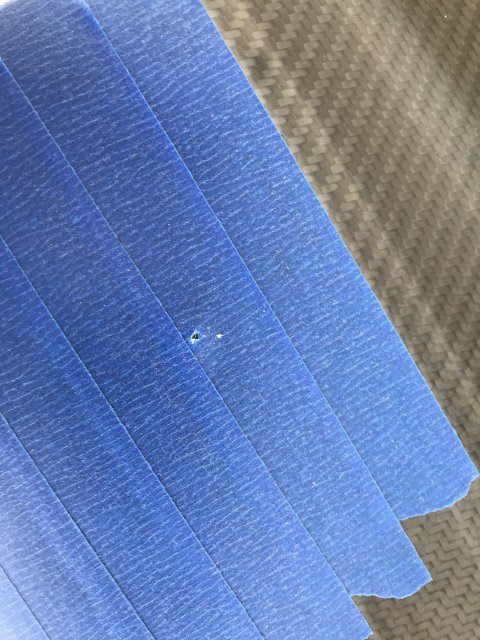

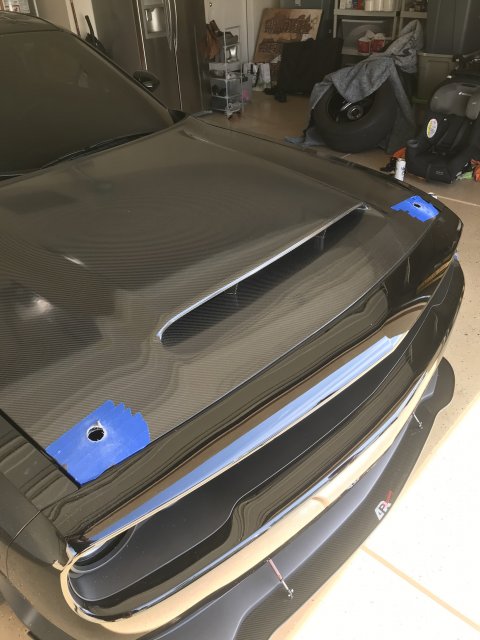

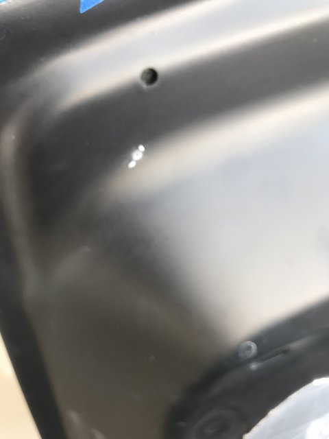

Well me and my pops did it our selves... Really was a easy job. Took about 30-45 minutes. Used some blue painters tape on top of the hood to prevent any cracking or chipping in the clear coat. Helps to prevent the spider Webb effect in the clear coat. 2B6ED622-1E62-403E-968F-671837BD54C3.jpeg 47E338DB-595C-4FDE-B483-C4962AD52C08.jpeg 42B01384-6D73-4152-8908-23CA419CFC53.jpeg E44A5151-D4FA-42B3-8AC9-AE31DE161AC3.jpeg 0DA60123-2F17-4CE4-8CDB-8EE40FFC8EC0.jpeg 1CCB7E14-372B-4B42-9268-2D1F4776C3CB.jpeg F4A7F75D-4AC6-4AB4-AF93-C5B74E6554AB.jpeg 9EC664A3-0FE3-462F-9956-7B76B71B0D6D.jpeg
