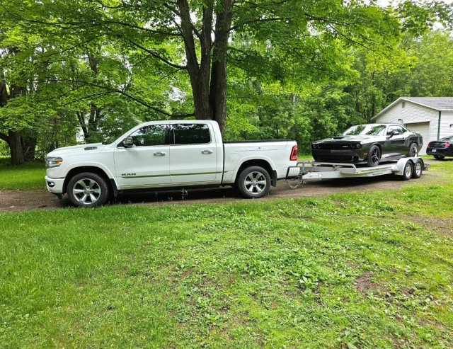

Yes I did back then with the stock 1500 suspension. Since then I’ve decided I prefer airbags. I’m towing the car now in a heavy 40’ tag with a 2500. I installed Air Lift Airbags and do not use the WD hitch. Much better.

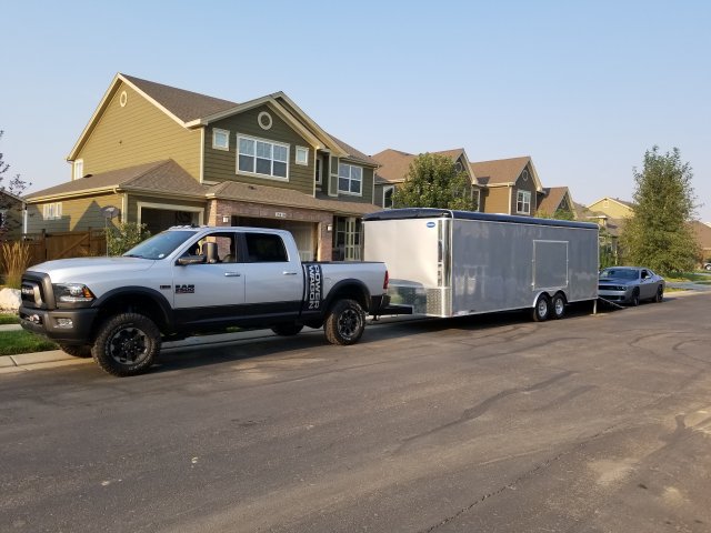

2017 Power Wagon 6.4L 2500 w/ enclosed trailer @ about 10-11k gross.
The reason I think this is applicable to your question is this setup is 3-4k over max towing for this truck, and with the Power Wagons off road suspension, towing was "interesting". Tongue weight was super important (as well as trailer balance).
But it worked well enough, but I'm not sure how many mountain passes I'd want to climb.
Make sure your brakes are in good working order and your brake controller is properly tuned for your trailer. I figured out afterwards that my controller had been set on "medium" instead of "heavy" for weight, brakes were MUCH better when set correctly!

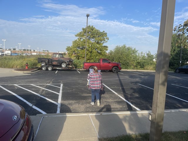

Not my HC but we used my little baby regular cab 1500 express to pick my wife’s 56 Chevy 3100 up in Kansas and tow it home to NW Ohio (880 miles one way) Did this about 500 miles after I replaced cam and lifters in truck and had 188,000 miles on it. Now it’s right about 200k on it and just did all the suspension and wheel bearings two weeks ago.
Buddies trailer and I think he said it was right around #2000 lbs, it’s all steel with steel diamond plate decking. I’m not sure what truck weighs but it’s all there, body, engine, trans, glass and everything.

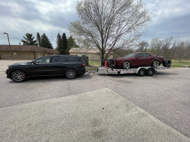

Great to see @DGatzby pic's of actually doing it! I was looking to see if Air Lift made bags for our Durango's, and they show their standard 1000 lb rear spring bags fit some Durango models, but have not called them to see which ones. Seem like a good thing to take the edge off the slight sag?

I thought Durango SRT and HC are both 8,700 lb capacity? Either way, it is a great number, but then as Jimmy reminded, physics cuts through any and all BS.
Sorry, I was generalizing, I think you're correct, the Durango is ~1000lbs more was the point.
