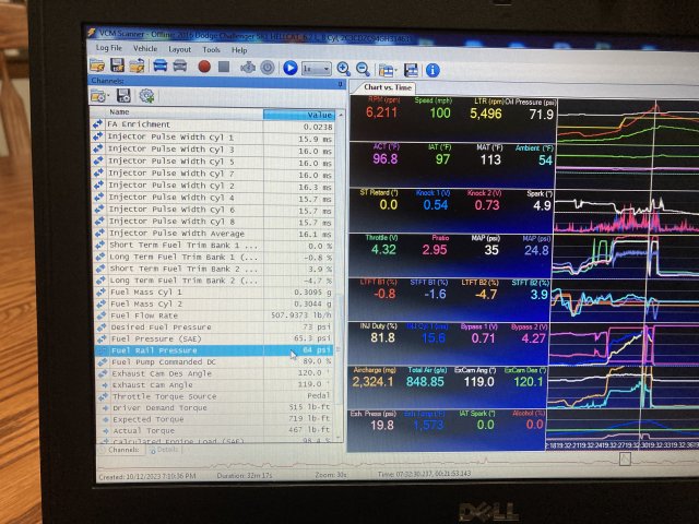

I need just a bit more fuel, fuel pressure dips just at the top of third and fourth (M6) driving injector DC up to just below bypass valve openning, hitting 81%, bypass will start openning at 85. This a Temporary bandaid until I add a third pump over winter as I’m not a BAP fan as a permanent solution.

My system will be going back to Tapped to add a third pump and FPCM over winter. I’m just trying to get a few hits in and maybe a dyno visit before winter. I was on the edge fuel wise with the 3.0 Whipple and 23-24 lbs of boost, now with the 3.8 and 25 psi of boost (maybe more??) it pushed me over the edge. I’m running twin 295’s atm with ID1700XDS Injectors. Third gear pull the other night was just on the edge of the bypass valve opening.

Mine dips to 64 I don’t think that’s a big deal, mostly 70-72 through the pull. Then again I have the redeye fuel rails but I don’t think that changes anything

Inj PW is important to note when looking at fuel system capacity. Interesting factoid, 2016 Hellcat has a 17.6 inj pw limit at 6200 rpm. More than that and the bypass starts opening. 2018 Hellcat is 13.7 in this same spot, as is 2019 Redeye. SRT got more conservative in 2018.

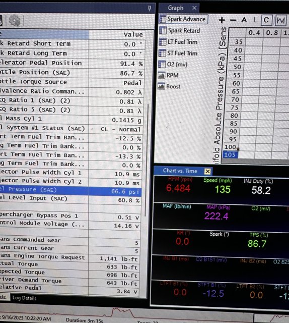

Exactly. Look at Unholy’s injector on time, 10.9 ms, I’m at 16 ms when my fuel pressure is waining down to 64 psi. I’ve got no time left!!! Now I’m on yet a different fuel pressure sending unit that whipple supplied but I’m looking more at injector on time atm then read fuel pressure accuracy, the injector on time is telling my I’m going low on fuel pressure, too low now.
