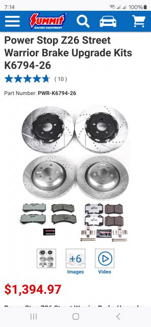

I've switched to PowerStop Z26 on all my fleet - daily's and the Hemi's...good compromise of low dust and decent performance, also have been pleasantly pleased with their performance slotted rotors too. I believe I have seen catalog photo evidence of a part number for the Hellcat 2-piece front rotors, but have never confirmed if they are actually available.

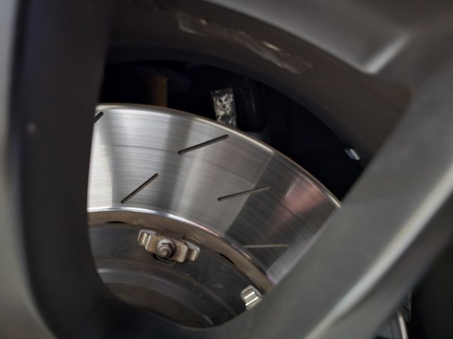

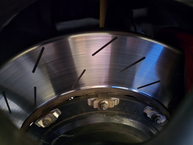

Pictures of slots

Pictures of slots
Great idea @DGatzby and @BULL. I appreciate any suggestions and opinions.
Fronts are here...
Thanks again. Front brakes are squeaking...which they have never done before. Thanks all.

About 1/2 - 2/3rds gone, turnable IF you can find a good lathe operator.
H-bobbins look ok from what I can see, but inspect the clips thoroughly if you use them again, they tend to start cracking after lots of miles and/or hard use.
Ok to use if you do get them turned AND are only driving in a "sane" fashion. Road course would want new with full mass.
Before worrying about or chasing any squeaking, do a fresh bedding and then evaluate, as always, be extra diligent about safety when bedding.

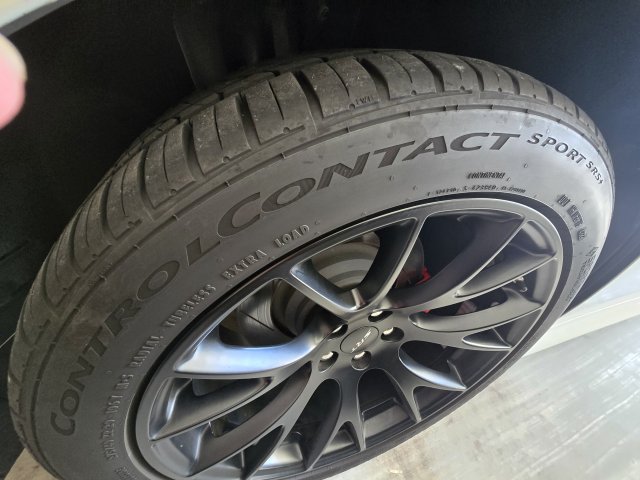

What tire are you currently running? The PS4s are really good, just wish they were cheaper LOL Gas and tires, that's all these things really need...well brakes too I guess.
Much cheaper than PS4s...but not as nice of an overall ride...maybe in my head???
