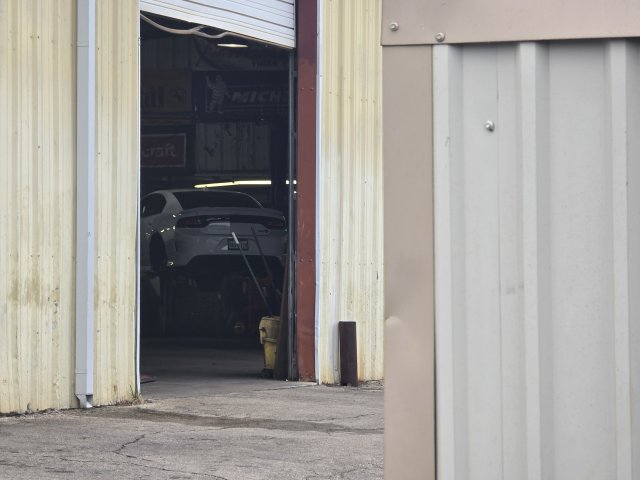

Ready to go...

Scheduled for this Friday...but supposed to rain so might reschedule.

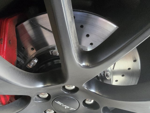

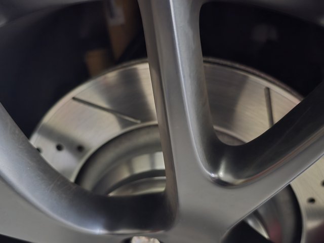

Got all new rotors and brakes installed this morning. Followed PowerStops brake in instructions (felt like Radford again).
Front:
20241101_111850.jpg Brake dust residue (hopefully good sign I did it correctly).
Rear
20241101_111909.jpg So far so good. Happy...but can tell difference between Brembos. Not a bad tradeoff for no brake dust.

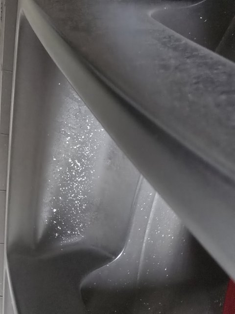

Now that I have broke rotors/brakes in...can I wash the wheels to get brake dust off or should I wait to drive more before washing in case I wash off anything meant to further break in?
Next project is PS4s.

Those PS should have nearly no dust. My chrome wheels confirm that. They must have initially busted off some of the rotor debris, you should be good to go.

Heavy bedding, even with "low dust" pads will do that, if you feel like they have the bite that they should, and you're not going to do a second bedding, clean them up. Although if you're going to do tires shortly, wait until that's done, because the wheels will have lub all over them after that and need cleaning again.

I did 5 aggressive 40 mph to 10 mph decelerations and 5 - 35 mph to 5 mph decelerations...then drove for 10 minutes without touching the breaks. Went to a somewhat remote road and hit it perfectly as no one was there.
That is what PowerStop recommended. Noticed some noise/movement when I come to a complete stop and let off the brakes...but figured that will go away. If rain holds off will go drive tomorrow to see.
