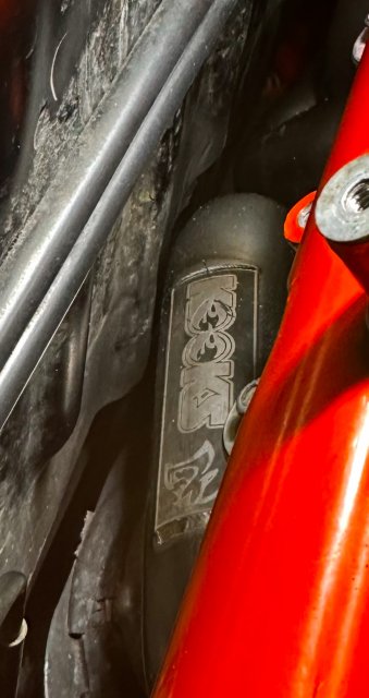

Called HHP. Said they’re only ever to get 1/4” and some are real tight. When it is, they bash the ribs flat. Not possible for me with the engine and cradle in the car, and the engine can’t be shifted over.
Ribs on the chassis?

I have enough room I think. How much room do you have in yours?
Stock exhaust. Plenty of room.
No headers? Thought you had them, must have been thinking if the race car
4,117
10,339
Correct have 1 7/8 headers on racecar. Plenty of room

Like I said, if they cause issues I’ll put poly motor mounts in and see if I can shift the cradle a bit

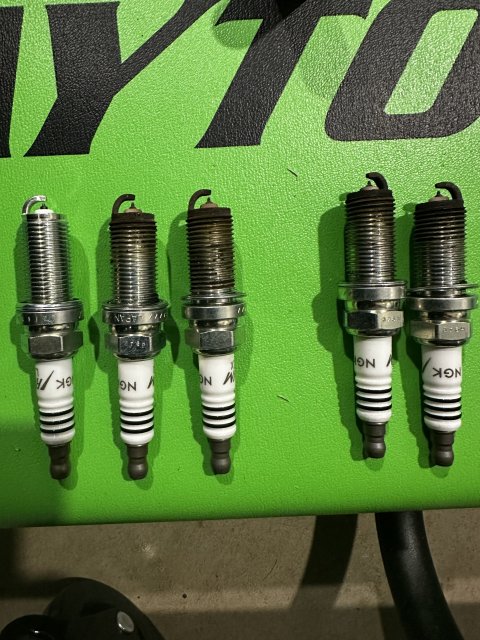

1 & 3. Will have to check to see what the gap is when I’m finished.
