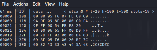

that's why I created this thread, to help get information out. Today I'm learning how to sniff the traffic the controller is throwing around:
The 2C3CDZC is the beginning of the vin, and the id of the controller throwining it around is 0x3e0, a few milliseconds later it will broadcast the rest of the vin. Right now I'm going to be setting up some brute forcing to see how you can get data with Caring Caribou (can utility). I'd like to see how to receive a PCM read and ultimately a write. I don't think any of these utilities exist right now on linux.

Small update, have been working on figuring out how to speak the correct language on the canbus, been doing a lot of research and found that the system uses ISO-TP. This means that if I send data to one arbitration ID (unique id) it will appear on another. This means I have to setup a sender and a listener. There are some good open source tools to do so namely isotpsend, isotpsniffer and isotprecv. All of them have quirks and nuances but make gathering intelligence easy. On top of the ISO-TP layers sits Unifited Diagnostic Services (UDS). UDS is to guarantee that any mechanic in the world can diagnose a car without paying stupid money to a higher conglomerate for proprietary data. These services are pretty well defined here: https://en.wikipedia.org/wiki/OBD-II_PIDs, andything above 0x10 is propriety but I have also enumerated those.
So when doing some enumeration I used the tools like follows (have to put it in a monofont):
to enumerate: echo "01 00" | isotpsend -p00 -s 7df -d 7e8 slcan0
response: slcan0 7E8 [8] [SF] ln: 6 data: 41 00 BF FE A8 93 30 - 'A.....0' - [???] Unknown
The bytes returned are hex encoded so that 1 means supported, 0 means not supported
1 0 1 1 1 1 1 1 1 1 1 1 1 1 1 0 1 0 1 0 1 0 0 0 1 0 0 1 0 0 1 1
Y N Y Y Y Y Y Y Y Y Y Y Y Y Y N Y N Y N Y N N N Y N N Y N N Y Y
1 2 3 4 5 6 7 8 9 A B C D E F 10 11 12 13 14 15 16 17 18 19 1a 1b 1c 1d 1e 1f 20
So of note you can request 01 20, 01 40, 01 60, 01 80, 01 A0 to find all the pids supported
all the way through 00 - C4, I would rather do this programatically.
to enumerate: echo "09 00" | isotpsend -p00 -s 7df -d 7e8 slcan0
response: slcan0 7E8 [8] [SF] ln: 6 data: 49 00 55 40 00 00 0C - 'I.U@...' - [???] Unknown
0 1 0 1 0 1 0 1 0 1 0 0 0 0 0 0 0 0 0 0 0 0 0 0 0 0 0 0 0 0 0 0
N Y N Y N Y N Y N Y N N N N N N N N N N N N N N N N N N N N N N
0x2 is the vin
0x4 is the calibration id
0x6 is the cvn (cali smog check bullshit)
0x8 is race stuff?
0xa is text name of ecm

I am building the software on top of SocketCAN which has built in drivers with the Linux Kernel, anyone that has this will be able to use the software. For greater adoption I'd love to use Windows but I dont' know much about it. Last time I did Windows development was 2002 and with the Win32 API.
4,117
10,338
Thread Starter #35
Status update, wrote two utilities. One to query what pids are available on the system and anothe to read all DTC codes. These were exercises to get used to how the GPEC2A controller talks ISO-TP over can. Since it uses traditional sockets it was quite easy. Now these are using traditional OBD2 "words", should Stellantis have put in special codes/mmenoics/hidden fuckery I'll have to do the research to uncover them but so far comparing my work with HP Tuners I'm on par. Here is output from HP Tuners:

Here is output from my program:
Created can socket with descriptor: 3
Applied filter to receive responses from 0x7e8
Bound can socket to interface: can0 (index = 6)
Checking for stored DTC codes.
Encountered a First Frame, buffering data.
Sending Flow Control Frame
Found 18 DTCs

I plan on writing some more utilities and then moving into the UDS services that were discovered and potentially figuring out the seed key algorithm. I will make most of the code potentially open source however I probably won't make the seed key algorithm or how to read/write to the PCM public, maybe a snippe or a demo but not a full program. Don't want to seem selfish but those could be additional revenue streams for me.

Almost ready for a first release of the binaries, decided against open sourcing any of the work I've done. :(
dpkg-deb: building package 'mopar-canbus-utils' in './mopar_canbus_utils.deb'.
new Debian package, version 2.0.
size 7752 bytes: control archive=380 bytes.
224 bytes, 9 lines control
