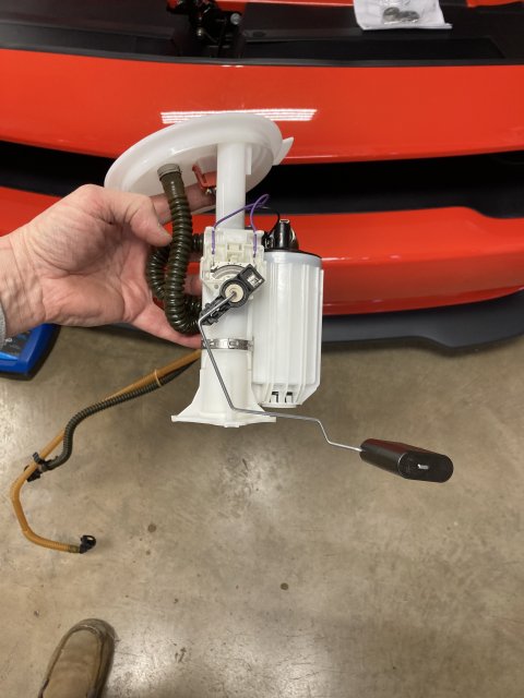

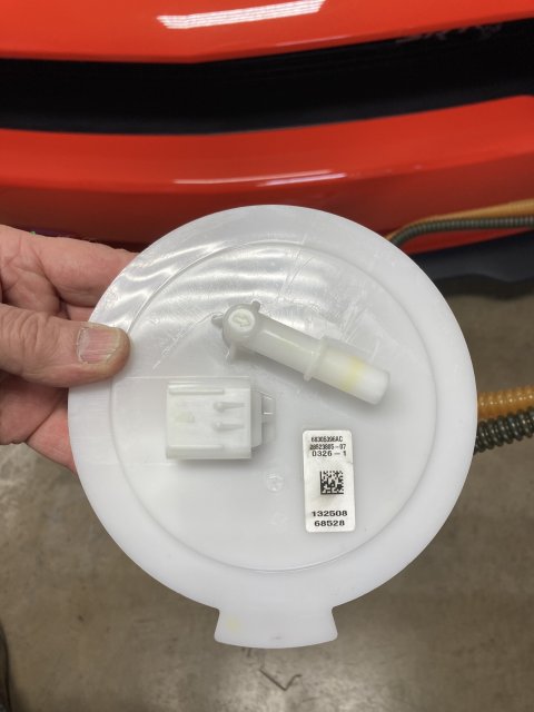

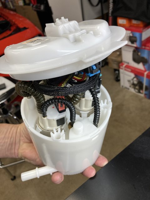

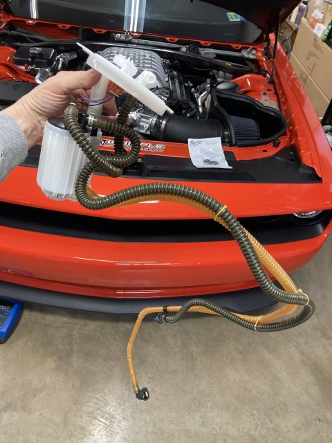

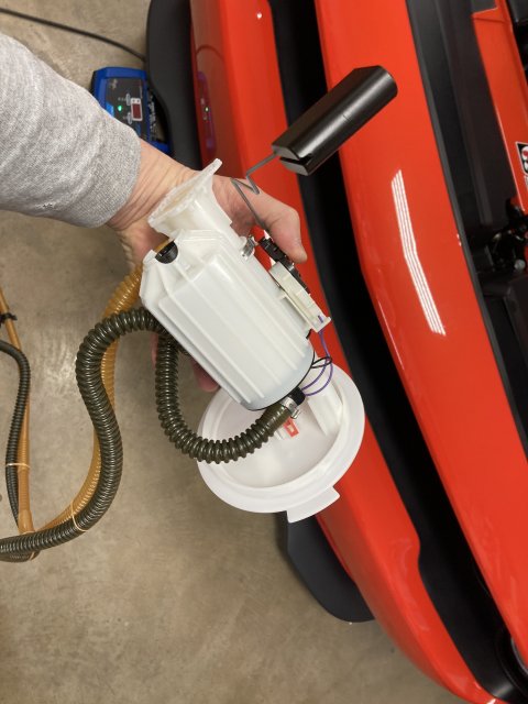

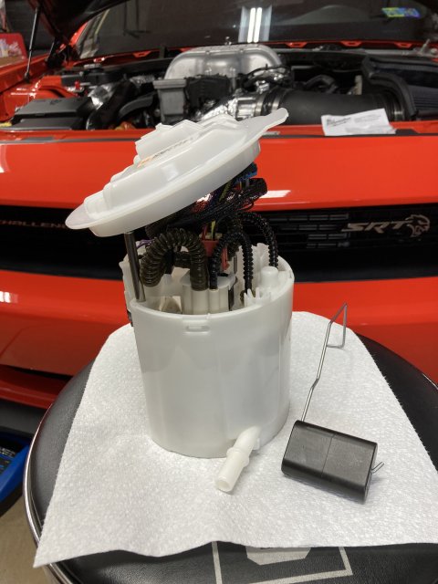

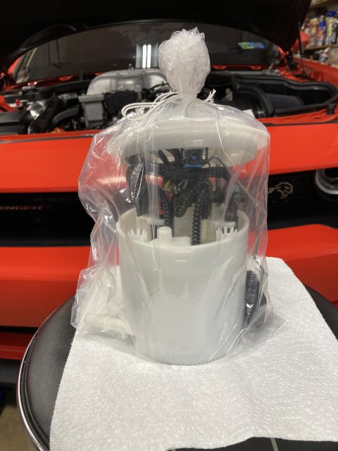

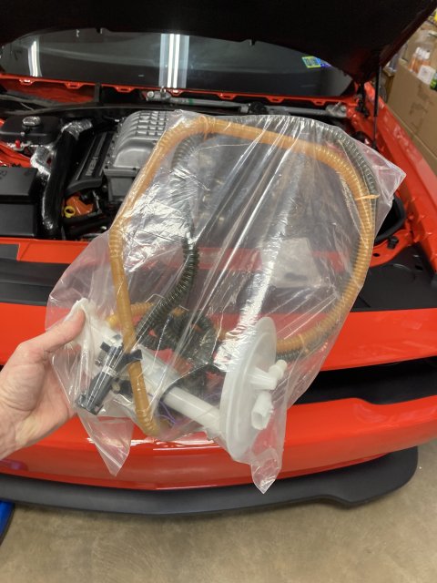

There is no pump on the passenger side, only a fuel level sensor and a device that looks like a pump but has no wires going to it, ie it’s not a pump! Fuel is pulled from that side by a Venturi effect from the primary pump (or pumps if a Redeye). If it were me I would be highly questioning my mechanic on this. Picture of everything that’s in the fuel tank under both bungs.
IMG_4053.jpeg IMG_4054.jpeg IMG_4056.jpeg IMG_4057.jpeg IMG_4058.jpeg IMG_4059.jpeg IMG_4060.jpeg IMG_4061.jpeg

Thank you very much for this detailed sanity check! I am definitely questioning this mechanic. I have a great history with this shop, so I trust the owner. I may have to speak with him if the mechanic keeps up these shenanigans. I can’t wait to get out of this apartment with its sloped driveway so I can get a lift and start doing/learning.

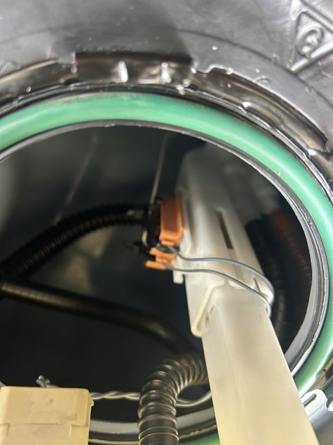

mechanic got the tank out, found out that the secondary sending unit was broken. Not even the whole unit either. Just the orange bracket and the fuel level arm. IMG_5995.jpeg

Wow, that picture came out great. :D They got it working kind of. I got my fuel gauge back, but I still want to replace that secondary unit. It's a little off. When I filled up the tank, it showed just a hair below full. They kind of rigged the level arm to work, but I'll replace the unit myself.
