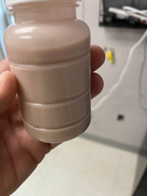

I've had my catch can on since my car was new, 2020 REWB. I've been religious about changing oil every 3k, I currently have 24k miles, Sunday I emptied my catch can and I got the usual 1-2 oz of oil but this time at the bottom of the catch can it looked like a vanilla milkshake. Any ideas?? It hasn't been run hard ever....

It’s just condensation mixing with the oil, it’s fine and totally normal

Normally I would agree, however my concern is that after having the catch can on for 3 years and never seeing this before has me concerned..

Check your dipstick to see how it looks? I wouldn’t worry about it if the oil is clean on the dipstick.
49,551
159,744
Since I have been running e85 when it is cold out I will get the same. Mine looked so tasty I almost drank it:p

It hasn't sat, I daily drive it... I was just disturbed seeing it and thinking it's something that could lead to a catastrophic failure. Like I said, Ive had the catch can on for 3 years and 24K miles and never saw anything like it...

No, I didn't think about that till after, Just picture lithium grease with a light coating of oil tirred together....

Mine tend to be a little more milk-shaky in the winter/cold season versus just looking like dirty old oil in the summer/warm season. I agree it's just a little more condensation that's not burned off. Run it harder! ;)
