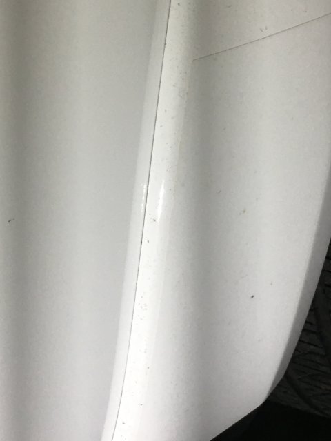

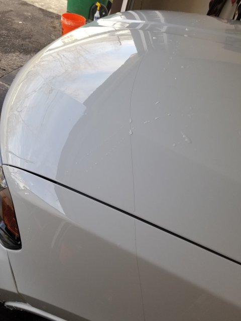

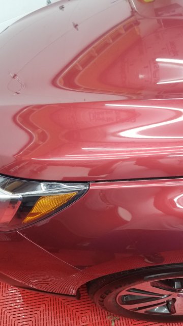

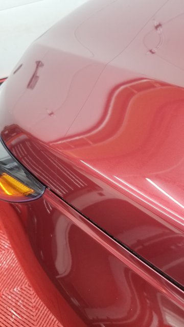

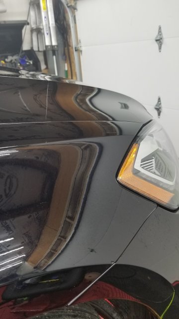

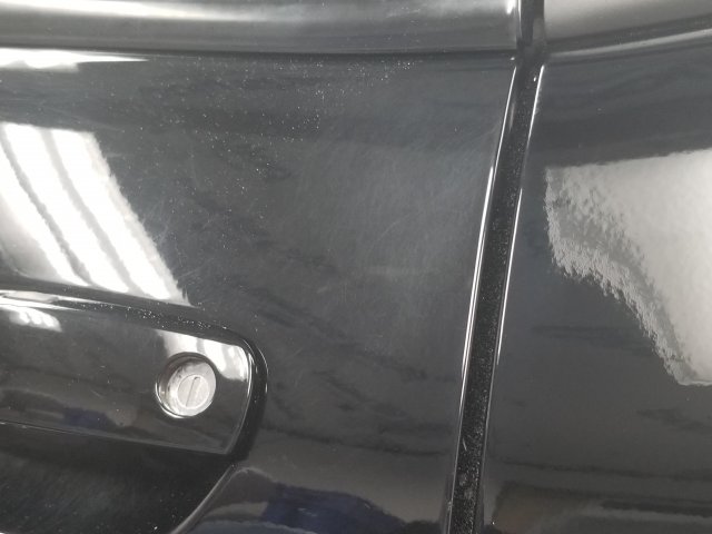

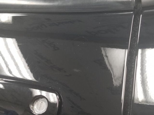

I install both PPF and ceramics. I have 2 plotters for different sized films so I can do full fenders and hoods. I have TRIED, I menan TRIED to do both my Jeep SRT and Hellcat hood in full piece. (I used a full role of film, 50 feet or $1100!) I've full hooded Mazda's and Subaru's with no problem. The deep recessions around the vents or intake is an absolute nightmare. I have just started doing filming this year, I've done about 30 vehicles, many with plot cuts, many with hand cutting. my vents around the charger are similar to what has been show, the edges start to lift, there isn't much area to grab, the film is stretched trying to hold on. The key to hand cutting is the cuts need to be over voids and not on the paint. So the edges of the hood or fenders, you can freehand those with scissors running up the edge to allow you wrap the edges. I have full fenders on my Jeep and Charger and a bikini on the hoods. Bumpers get tricky if you want plot cuts, the Jeep is 4 pieces, the Charger is 3, so you end up with seams. Someone who bulks may be able to get it in one piece.
If you run a bikini line or fender tip, you will have a line, it's only noticeable in certain light on certain angles. The light needs to be reflected through the edge so it can be seen.
As for ceramic, anything over 2k is you being taken. Unless you have a showroom car that is never driven don't pay for 95-99% correction. It just won't matter. Sure it will look awesome at the shop, you take it home and put 5k miles on it, you're money is gone because your paint will pick up defects. You can pickup 70 or 80 or even 90% with a good one step polish and pad combination. Sure you can further refine it with a second step for more gloss. The average person isn't going to notice a difference the higher % you go. I do a full decontamination followed up by a one step polish then lay down a professional coating for $750 on a standard sized car. It's good for 4 or so years, even if you get 3 and re-do it, you'd be at $1500 to 2 surface reconditions and coatings compared to some of these outrageous shops. I know of one place that charges $1000 to ceramic coat PPF. No prep is needed on the film, $80 in product and 2 hours of your time, these guys are ripoffs.
I attached a few pictures, the paint was one stepped in the picture of the door pull. The others show bikini lines.

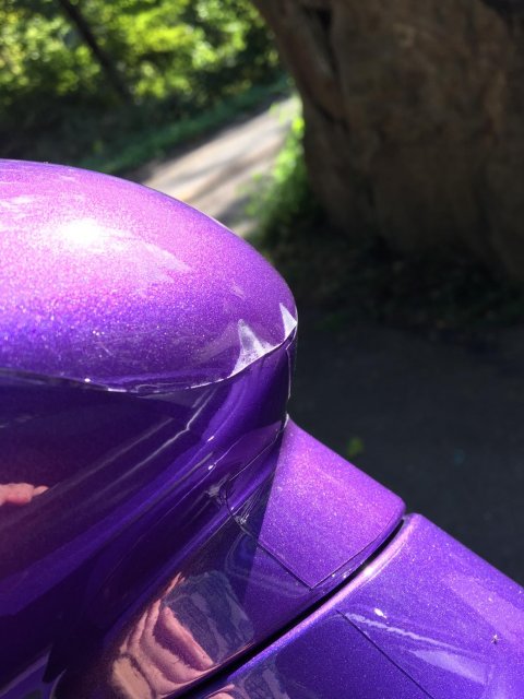

The leading edge of the rear flairs on my wide body Scat got chewed up pretty bad in about 4 months and I had a few rock chips on the piece in front of the hood so when I got my new car I had the PPF installed on these pieces.
The Scat was ceramic coated and it held up well so I had this done to the new car also.
And mud/rock flaps.
