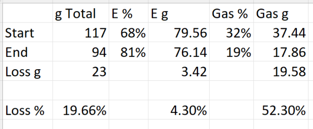

Noticed the E content changing upwards after sitting in the tank a week. Did a quick experiment today. We all know about this but I was surprised at how quickly it happens.
Put some E85 that tested E68 in a cup this morning, figured I’d leave it overnight and test. After about 4hr, it looked like so much evaporated that I might not have enough to test now!
Turned out, I had just enough with a few drops to spare. It tested E81!!! Not what I expected!

I would have thought the E would have evaporated faster!
The low vapor pressure is why 'E85" is not available in northern climates including NH, ME or VT. I have to drive an hour into MA unarmed to get it!!! :mad::mad::mad:

That's interesting. Kinda how alcohol and water chemically bond and 1 gallon of water and 1 gallon of ETOH doesn't equal 2 gallons of liquid.
