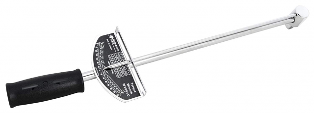

For now, just use the time tested method of turning the fastener until it starts turning more freely again.
Then back off half a turn.
