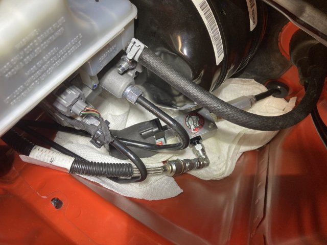

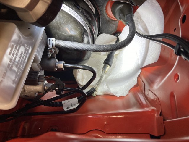

Here it is in the line before I took it out, the paper towels are just there under it to catch the brake fluid that came out which was just a couple drops. See the brake booster to the left? It’s right there in the corner next to the firewall.

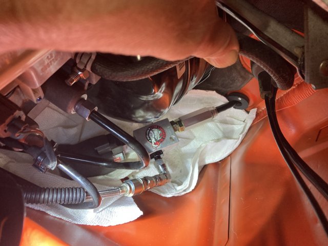

Here is the BSB plumbed into the clutch line minus the CDV. Notice the paper towels barely have any fluid on them, I had it apart 3 times and only a few drops of fluid lost.

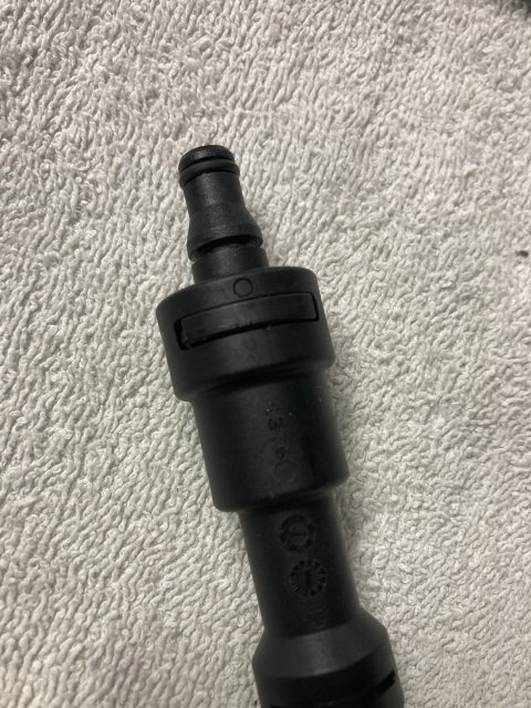

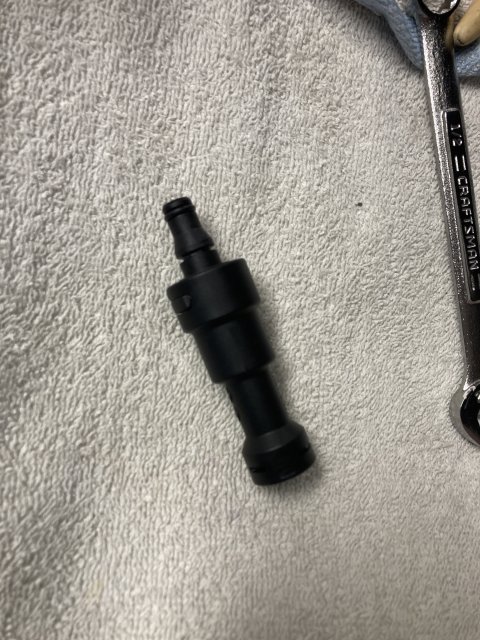

Here is the CDV by itself. See the slot, that’s a plastic U clip that holds the male end inside the unit and keeps the guts inside. Pull out the clip, pull male end out of the body, the 4 pieces come right out, put the male plug back in and put plastic clip back in, gutted CDV, put it back in.
