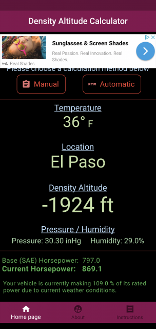

Not sure if this is the right spot for my question, but I'll give it a go any way. I've lived here in the high desert of El Paso for a couple of years now, and I have heard several people blame the altitude for s decrease in horsepower and performance. My question is does the altitude supercede or override good DA? I have this DA app on my phone (streets DA) that can use your GPS location to automatically calculate the DA. For example, rightnow it is telling me there is a DA of -512ft in El Paso. Assuming the DA is accurate am I still going to loss power due to high elevation? Thanks for the help and insight.

There are four components. To answer the question you start with your elevation. There the elevation is 3740’. So without anything else you have a 3740’ more of a problem with DA than a guy at sea level.
Given your weather conditions right now; 54 degrees, 30.12 Barameter, 8 degrees dew point (that one right there is a big helper). I got 4089’ DA.
Did you remember to give the app the elevation?

When you select the auto calculate it only ask for the horse power and then uses GPS to calculate DA. I'm not sure if it takes elevation into account.

So basically the app is trash because it doesn't take the elevation into account, therefore giving an incomplete calculation.
If it is using GPS worth a damn it should have your exact location and, ergo, AASL - it's the weather data components it would be missing unless it's tapping into the nearest FAA / NOTAR or other weather info automatically and just not showing it to you.
Here is a screenshot of what the app tells me the DA is currently. It spits out a projection of what the cars performance should be. However, the numbers aren't even close when you add the elevation.
