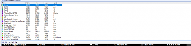

I just did a pull the car read 17psi. DA is +850
Speedy- I just looked at pRatio and it reads 2.190 for the pull I just did. I'll have to find a good PRatio calculator
I'll have to add the Air Charge PID I thought I had it but I guess not.

What should air charge be? I just added the PID.
7,265
18,966
That all matches up.

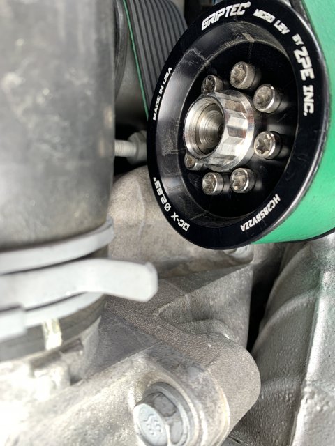

You double check the pulley size?
Yep checked it a few times before install.

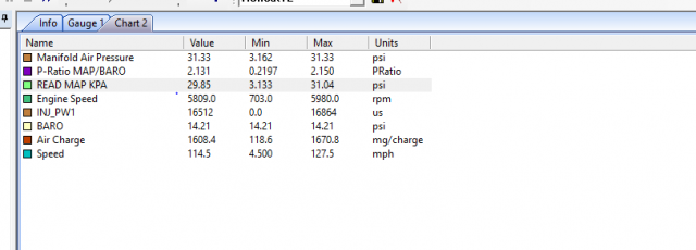

Here is air charge. Is that low?
7,265
18,966
#50
It's not low, but mine will see 2000+ in good air as a reference point. I'd say things are normal.
