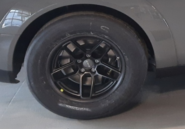

Interesting video Demonology posted on tire spin. Says its spinning 12-16 inches. Car needs beadlocks I find it hard to believe Dodge didnt notice the bad tire spin when testing.
I m surprised with all the snot they put on the rims / tires

Spinnin ain’t winnin! And these mickeys suck to mount in this size, always have

I am not a fan of beadlocks….. I think a little tire slip is OK because it takes a percentage of the shock off the driveline and I couldn’t say how much lost ET you get but I doubt it’s much. The other issue that no one seems to talk about is putting the tires out of balance after a couple passes. An easy fix is have the tires bead balanced, that way it doesn’t matter how much the tire moves on the rim.
