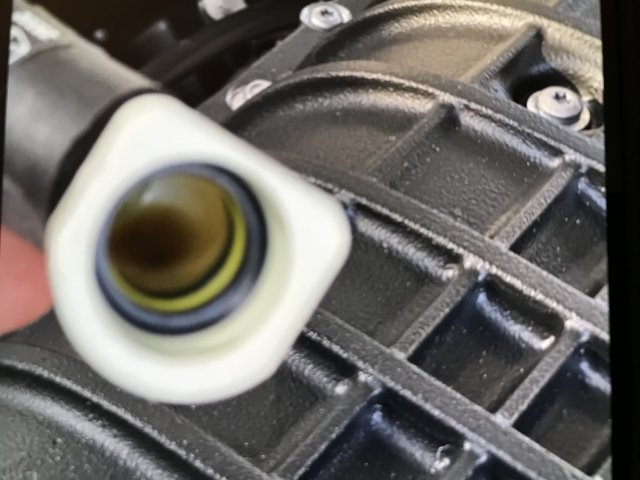

You’re right Speedy. 72 miles here. And small deposit already. I have not put my foot into it so no boost yet to speak of that would cause positive case blow by pressure yet. So I am thinking some of it might have gotten by from run in test at factory and rings not sealing 100% yet. Haven’t looked down it’s throttle body yet, but no doubt it’s going to be my first mod.

I get zero blow by since I have the valve cover vent. Catch can has been 100% empty for 3 track trips
8,512
7,442
If you don’t pressurize the crank case you won’t get blow by sucked into the supercharger. I swear the car has operated better all around with the vent

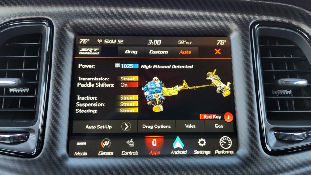

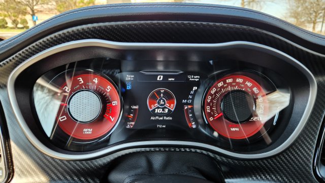

A little testing today, more to come :cool: What I'll say is the sensor reacts MUCH faster than the inferred I'm used to. Once the fuel hit the sensor the E content rised rapidly. I'm shooting for E70 and just about nailed it.

You have been being good 12.9 mpg
