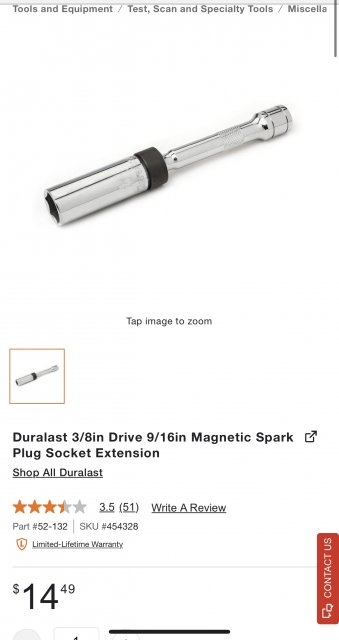

I guess the part number on the socket isn’t correct but this is exactly what it looks like (I know this one is the wrong size). You can put a socket wrench right on it and get them out without any additional extensions, maybe a 1” once on top of it for the back ones. Get this in 5/6. The magnetic part is amazing. Some of my best tools are duralast

And I have a screw in plug gapper, better than smacking them and having the pry it open if you hit it too hard

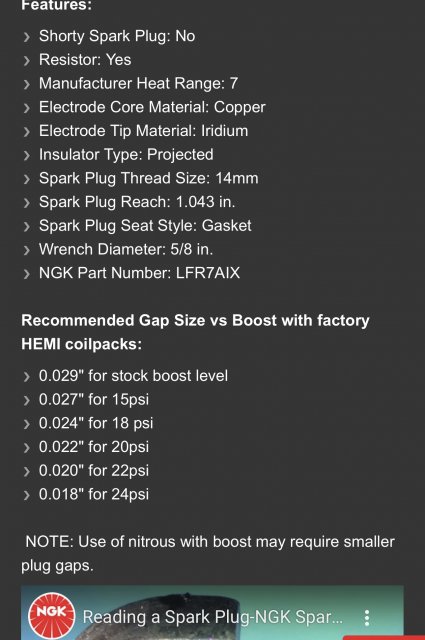

Hmm according to HHP by gap might be too big?

Wider gap is for fuel economy but you will get spark blowout

Yeah, thinking I need to close up the gaps. I’m around 17 lbs of boost
