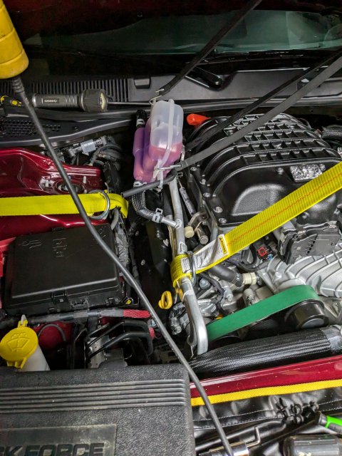

The ratchet on the black box and wire is a new one. I left mine disconnected from the firewall last time I did them. I shouldn’t have put the black box back on when I replaced my headlamp to dash harness.

Hardest part of doing the plugs is getting that damn black plastic box on the pass. fender out--the one that does /nothing/ but get in the way. Rip it out and throw it out. Once that's gone, access isn't too terrible on any of them.
