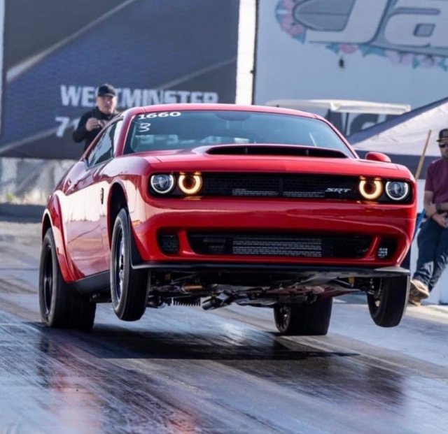

I hear this is Ron’s car… seems he has figured out the launch. Not sure it has the power to carry them for 60’, so that 1.2 60’ is probably on the front tires and not the rears, but impressive nonetheless
I would say at least 30 to 40 feet.

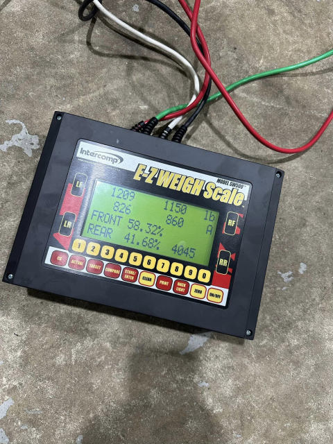

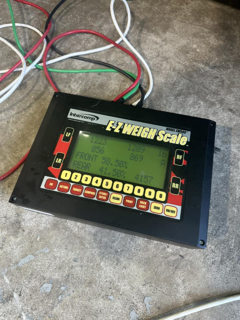

Phase 1 of our Weight reduction journey with this car, want to document changes
Old weight was 4157 (bone stock, less than one gallon of fuel)
New weight (4045)
Changes:
Ripatuned spec wheel and tire combo
Antigravity h8 lithium battery (actually too large for the car, we will be using a different battery for another 14 lbs in savings)
Front sway bar removed
Titanium lugs
4.5 gallons of fuel in car 6.5lb per gallon (30lb additional)
Overall weight savings 132lbs
I wonder how much the 132 lbs cost?
7,473
19,638
My only problem with Ripa's setup is the tires aren't DOT approved. Seems the class that car would be suited for will require DOT tires.

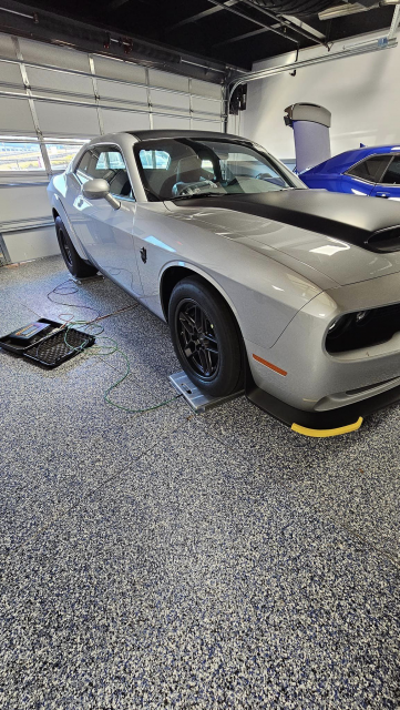

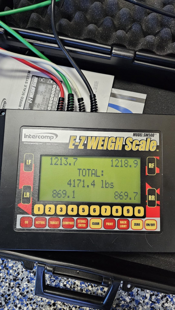

guess someone else wants to post pics like ripa:rolleyes:
Single seat, carbon wheels, 1/4-1/2 a tank

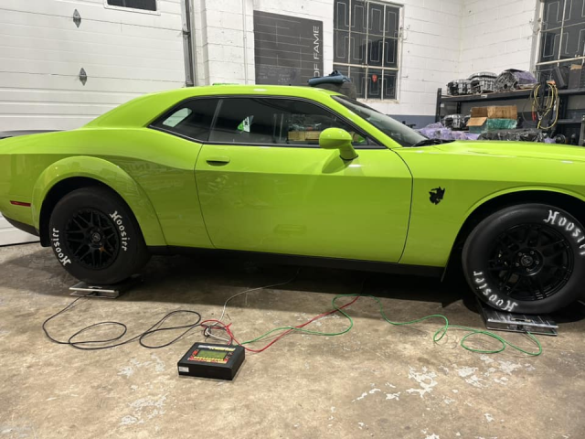

Here is ripas one seater, less then 1 gallon fuel weight on top and duster one seater, between 1/4-1/2 tank of fuel with carbon fiber wheels
