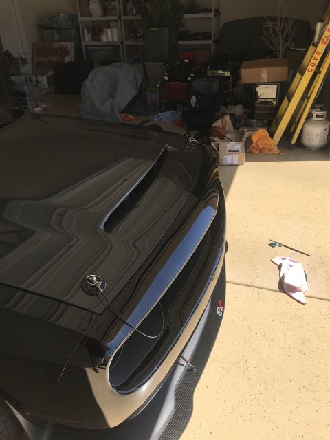

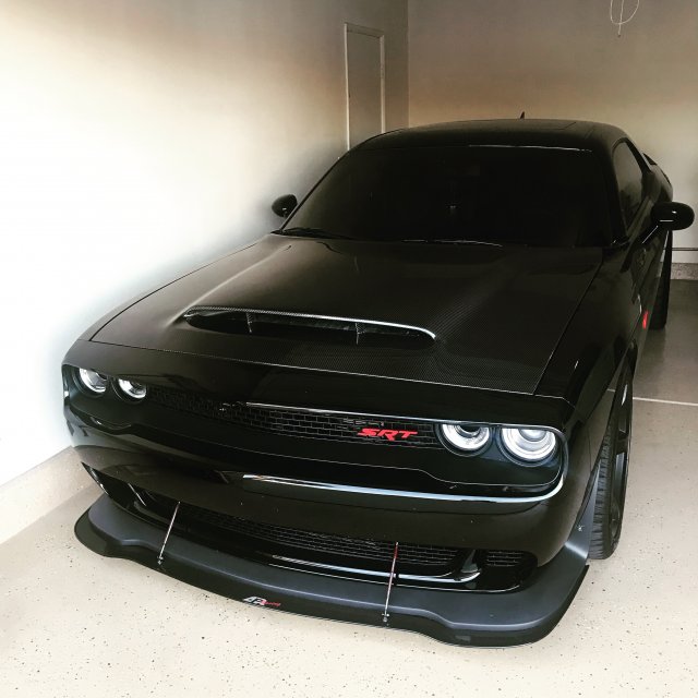

I upgraded to a Carbon Fiber Demon hood from Anderson composites. It is badass! 8A82BC9A-04DD-4A01-9279-CDC68DA78630.jpeg 6315F7BF-79CD-4F0B-9C9D-17D78B357D47.jpeg

That is pretty badass. Do you utilize the airgabber? You've found it secure without hood latches? The lines and fit and finish look really good.

Good questions. Anderson recommends hood pins.

My cat is a 17. I noticed with the air grabber and running with the LMI my IAT’s dropped about 20 degrees or so. Also I ordered the Mopar black hood pins and gonna install next week. It’s also 4.7 lbs lighter than stock.

Do they say why they recommend hood pins? I like the look without them. Also did you use the factory hood shocks?

Yes I used factory hood shocks. It’s recommended by AC. I will be competing in some 1/2 events so that’s why I’m installing the hood pins. If your gonna hit any high speeds over 130 plus, you better do the hood pins. 1700k+$$hood= hood pins= cheap insurance.

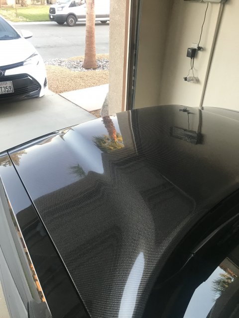

I have an Anderson Composites carbon fiber Hellcat hood. Fit and finish are as good as it gets.
I did use the Mopar hood pins on my install. At hi speed, if you don't have a steel hood, the forward outer edges can peel up and the hood then becomes a wing. For just a little while.
If your lucky, it leaves the car and you can still see to steer.
If your not, it peels back over the windshield, and then you're screwed.

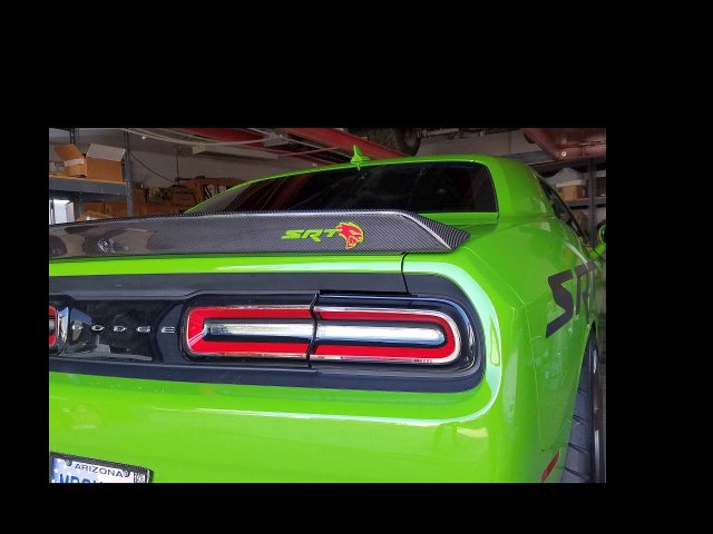

The make a nice carbon fiber rear spoiler as well.
