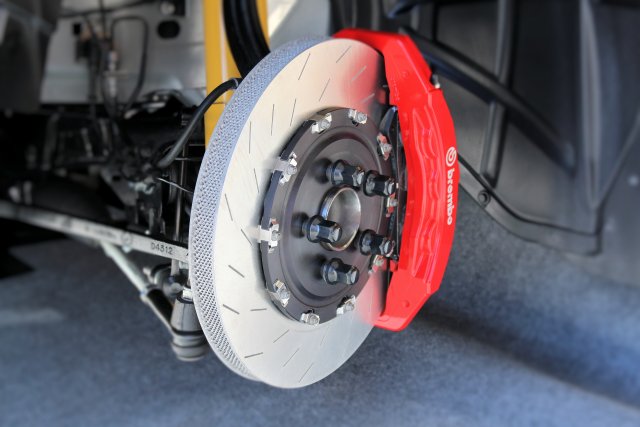

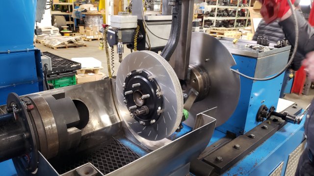

We've been testing various iterations of core design, coatings (more on this in a bit) and slight variations in material, both on the brake-dyno in Detroit as well as on-car testing with @BULL's Challenger. And while there was a certain level of success in that testing, our goal is not to deliver anything short of 100%. If we weren't trying to satisfy halo-car drivers, for cars that weigh 4400lbs and can achieve 200mph, we might have been done ages ago.​

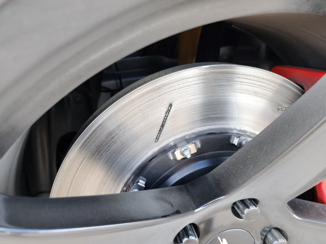

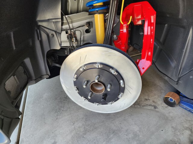

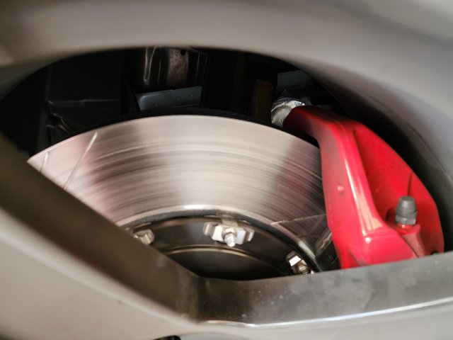

(A couple of on-car shots of two different iterations)

3D printing is at the heart of this design challenge, it allows for a heat-exchanger design (really what a brake rotor is) that can not be cast due to internal channels and paths, as well as what is generally referred to as "thin-wall" features. In a simplified way, these features are the basis for our patent. This is what makes this rotor so much better, it's ability to dissipate heat energy. All materials have various thermal properties, and among other reasons, this is why we initially chose the A1000-RAM series material. The thermal conductivity is very high. The initial A1000 designs that went to Detroit to be tested, on the same brake-dynos that the Big-Three use, performed so well that the technicians had to dramatically shorten the dwell time between test sections because the rotor was cooling off so much faster than they were used to!​

Those fender wells seem to clean for a test car 😉
CDT Rotors
CDT Rotors
#2049
98
321
Frederick
Challenger Hellcat
He can be a bit OCD
