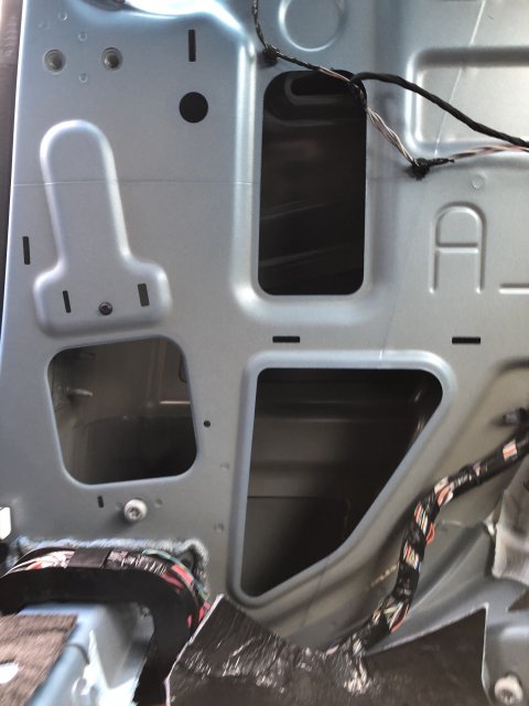

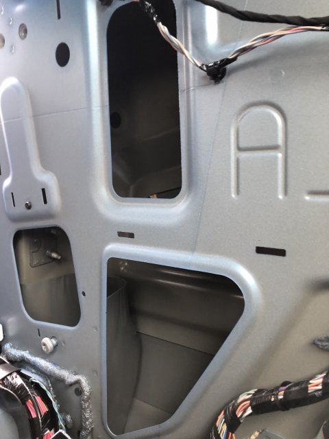

Ill have to pick up the book Stormtrooper. Thanks. So here’s the latest: went to see a guy my cousin (another car guy) recommended. Ive got an appointment for next Monday for repair. In the meantime I pulled the interior out of the rear to make it easier for the guy, and cheaper for me. What I have pictured is what he’s going to have to deal with. Plenty of wiggle room in the cabin but plenty of bracing between him and the exterior panel. Too bad the Mopar rear seat delete kit isn’t available, I’m pretty much there.
D623AEFF-F3D0-45E4-BE9F-DF208DE153E4.jpeg 77211A2B-8EC2-4E77-B0D8-DD83448DA5CA.jpeg 5CB222B3-3500-4067-AC84-2A6313325373.jpeg
20,160
lol, you didn't remove that factory trunk brace?!
That should make it a piece of cake.
