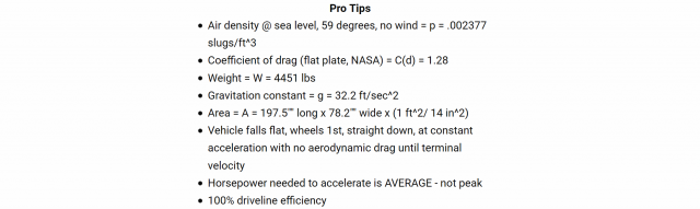

Well this didn't take long...
I believe there is a typo on the official page for the contest...
"14" should be "144"???
I'm also finding an issue with the "distance to terminal velocity", but perhaps I have an error in my calcs.
Yeah, if you look at the screen shot from OBC it shows 144.

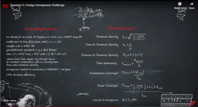

Well now, numerically, there isn't much ambiguity in the math this time. There aren't any factors that aren't supplied.
So you would THINK that you would find an exact answer, would you not???
Thanks for pointing out the 144 vs 14. I took a screen shot that had the 14 and knew something didn't seem right.
I haven't put too much thought into the calc yet, but some things are shown in feet and some in inches, so do we need to convert all the given inches to ft.

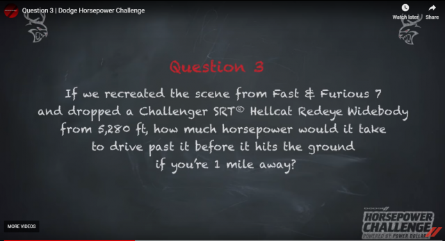

It looks like this question does not take into account the total distance the driving car has to cover because of the length of the car driving or the width or length of the falling car depending on the direction it is facing. This is assuming the driving car passes through the landing spot instead of to the side.
