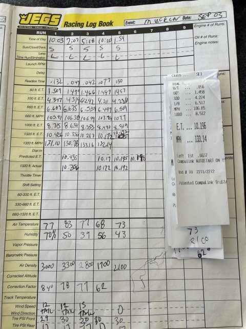

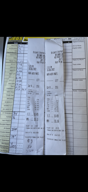

Don’t shut it off.
Keep it running.
even if they tell you to
I start the car when the 4th car ahead of me
Hits the stop sign.
It stays running after that point.
unless serious clean up is needed.
Mickey is the tire
Nothing goofy
With these.
I kept a log of every run for 4 years EE4EE899-A006-4598-9D16-7B4CCB67D6DD.jpeg
I can and try to predict the et before each pass.
I use a hand held weather station.

I kept a log of every run for 4 years View attachment 84869
Mine is similiar
2,228
3,826
Guys
http://crewchiefpro.com/
Combine it with a good weather station to go with your data logging.
Every big time bracket racer has this. Works really well once you load it up with data.

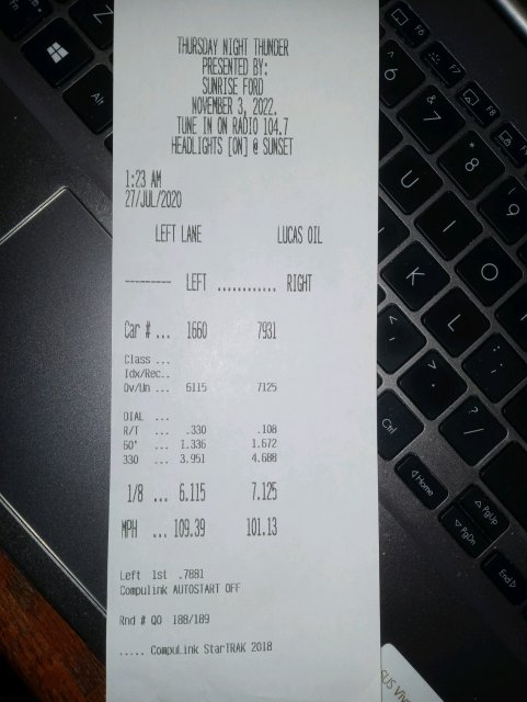

OK, So Irwindale was a blast this week. 1.5 hour delay when one guy oiled down the track 3 cars in front of me. I stood there the WHOLE time and watched them clean up. The fast cars run singles in the left. But the oil down was on the right. They rig sprayed the whole right and it looked amazing after the cleanup. I was planning on going in the right. Then the VERY NEXT CAR oiled down and crashed in the right lane. Everyone was freaked out because they thought the cleanup was insufficient and was the cause of the crash. I knew better. So, another 1+ hour delay. The motor got a really good cooldown. So it makes more power and the DA was heading D O W N. So they ran a bunch of slow shit just to prove the track out before they let the fast cars run. So we had to sit right by the water box while all these knuckleheads funneled around us and proceeded to jack the track surface up. So I DID take the right and the car did not make a good pass. All that waiting for nothing.......
But the DA went down to 100. Rare at Irwindale. So for my last pass I took the left. On this taller Hoosier and with fuel that could be a little better, the car busted out a 6.11 with a 1.33 sixty foot leaving at a conservative 1500 rpm. DANG, I will take that. Since it was so cold the car was wobbling on this pass and I am not 100% sure but I think it was running out of gas. Maybe sloshing fuel? The level was not THAT low. It was hard to tell, but I stayed in it because I KNEW the DA was killer. On better prep this car will be in the 6.0's when set on kill.
BTW, it will take a 6.06 to beat Nephtali's 9.504 in the Quarter Mile. I am coming for you......... In Huston I think I can do it.
BTW the MPH was almost 112 on that less than ideal pass before this. So this likely would have been 3 MPH higher or so.....

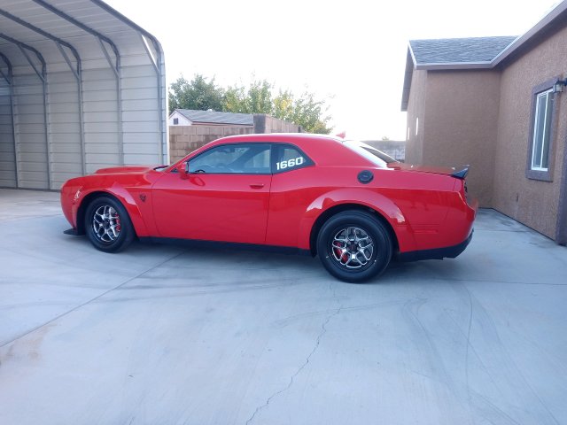

Car is set on Kill. Lets see how she will do tomorrow.........Sunny and 68 for a high........
