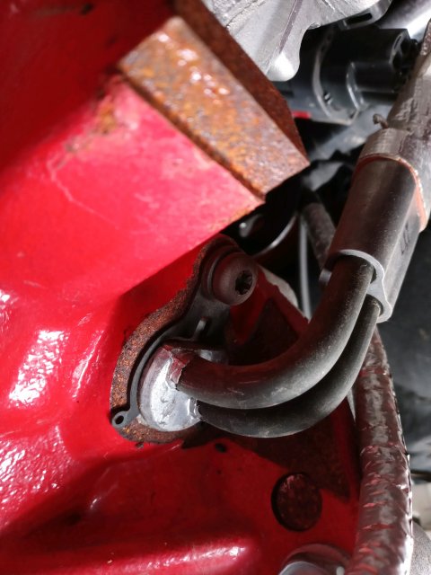

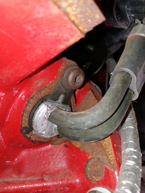

OK, here is my Question for removal, which I do not think I will do. But just in case. Does it go into the bellhousing area, a well in the side of the block or the coolant passage? It looks like it is at the back of the blosk on the Drivers side. I am not interested in draining any coolant to do this. Maybe it is stuck? Another downer is that it is routed under the coolant recovery tank and the wires are encapsulated under some plastic with a super adhesive. So you are not going to just jerk it out of there...........I happened to take pics today while I was.......... 0907210954a.jpg 0907210954b.jpg

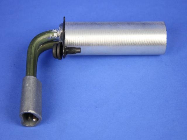

This is what it looks like in whole ...
I don't think it's the coolant/frost plug type, but just metal on metal heater.
Unless that spot is just normally open without a cover? Maybe someone here who might have their Challenger up on a lift can look at the same spot to see if they just have an empty hole there?

on second thought, that cylinder looks aluminum. Chances are, if it's a snug fit, it ain't coming out without a fight, if at all.

It doesn't go into the water jacket at all. It is just a cast in hole that it goes into. So you can remove it easily.
