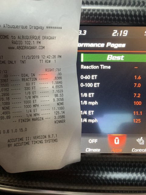

This is what my car did using the chiller on 3 back to back runs, I tried hitting it a little harder on each launch. They were all withing about 15 minutes total. I kept spinning a little and having to feather the gas a bit...I have 60-footed in the high 1.5s so was trying for that, but I don’t think it will 60 foot much lower than that on a 275 drag radials, unless there's killer track prep which is rare here LOL. Car definitely doesn’t fade when you run it!
You can see that altitude effecting that top end! Nice work.
