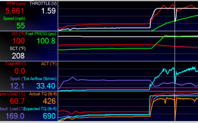

So in higher DA the transmission could not complete the 2-3 shift on time when loaded heavy. This is with the 30" tall rear tires, and after adding 100 pounds of balast and at 1500 DA ish. You can see that the shift is commanded and has started pulling down the RPM and then after the fact it clips the throttle to help the shift complete. Plain as day.
The RPM had peaked at 6343, well below the rev limit and was already down to 5661 and then the throttle closed. TRANS SLIP 6343 PEAK.png

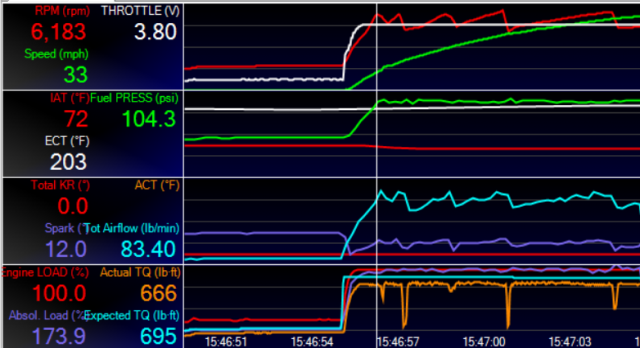

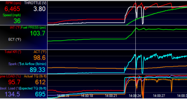

This is a double Hiccup in good DA at the Legions event. It hit the rev limit on the 1-2 and the 2-3. It hit 6469 rpm on the 1-2 and closet the throttle and on the 2-3 it hit 6524 rpm and closed the throttle. When the car does this it's an easy tenth slower if not more.
