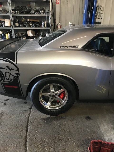

64017402-91B8-4E17-970D-65A75B4D5AEF.jpeg 64017402-91B8-4E17-970D-65A75B4D5AEF.jpeg If you guys want to go faster add this sticker

that DUSTEROFF sticker looks good on the silver

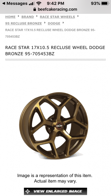

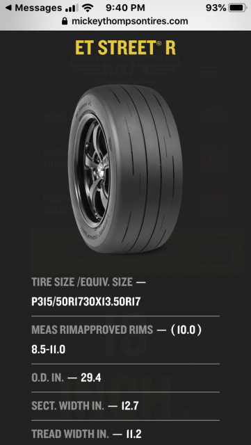

I just ordered these for Christmas, 20” DR’s will be for hunting to and from the track
5B77ED32-440D-4CCC-9313-A1B97A99A9C1.png DB588EAB-381A-4EA7-B87C-026CBF1BE337.png
