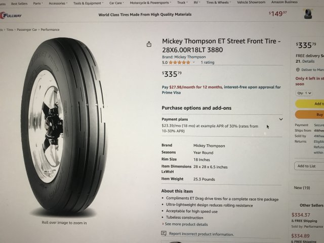

Their maximum load at 50 psi is 1140. Multiply that by four and add a 200 pound man are they suitable for a fully weighted hellcat at the strip. I am talking about the 28 inch ones for an 18 inch wheel. Radials. They do make a street version at 25 pounds a piece.

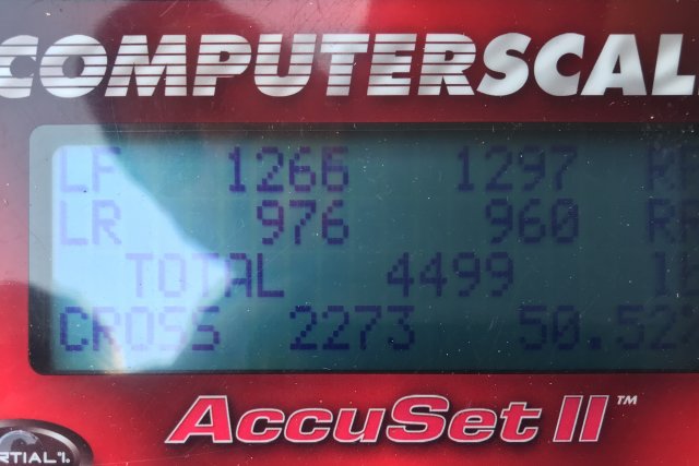

You can’t take the total weight of the car and divide by 4. Mine back when I was at full weight…. 892A98A1-9C76-4004-8C58-A5414BDB86E6.jpeg

You can’t take the total weight of the car and divide by 4. Mine back when I was at full weight…. View attachment 115795
So you are making the point to stay away from the ones that state 1297 or below. I am not sure if you were sitting in the car with these values. At any rate I do not feel comfortable with the Hoosiers. I think I will go with the heavier street radial version. I do not think it will slow the car down that much.

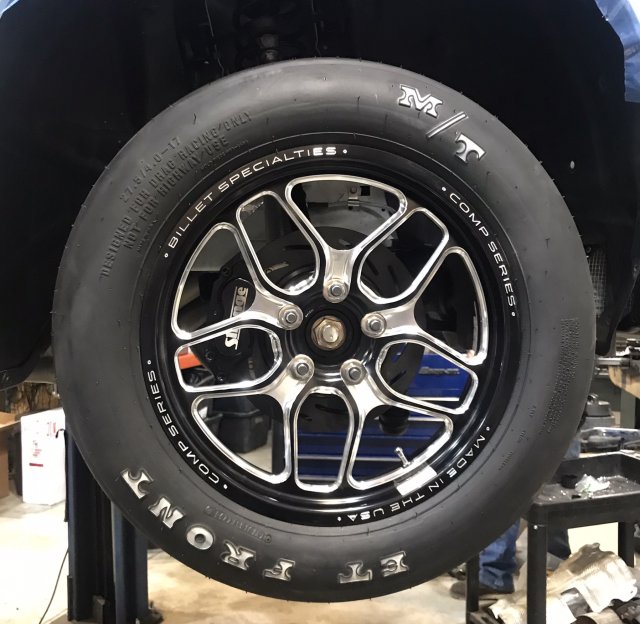

On the subject of front runners…. The M/T Sportsman is the best for a heavy car on the street. Potholes be damned. M/T has a newer ET-R front that is rated for street use and the older ET Front that are not. These drag only tires don’t have a weight rating. They are very common on very fast (200mph) cars and I’ve never heard of their being a doubt about their safety. 5EA13916-84E4-47ED-B60F-79F9F80967B2.jpeg

Are the newer ones on their website? Definitely want to get rid of the bias Hoosiers.
Yes I was in the car. The max weight ratings the DOT puts on there have a wide safety margin (liability) built in and are rated for that on the street where they have to deal with potholes and bumps without damaging the tire. I’m not suggesting anybody should discount the government’s concerns for our safety, but…. 🙄

I think the newer front runners are not made in an 18 inch variety. Marc, you probably have a smaller braking system up front and are using a 15 or 17 inch wheel up front?

Yea. They know that the modern muscle cars are heavy and that LT rating brings weight. If you are still on the street then the weight is worth it. These things match the ET-R rears and they say that they are designed to go with those. I have no experience with them so can’t say how they might perform on the street. The Sportsman's are great.

They’re way lighter than 25 a piece.

The newer ones are 25.3 pounds a piece. And very slightly wider.

Well, maybe. I forget. My 18x6 forgestar f14 skinnies with that same tire weigh 32lbs

Strange, mine have the same weight rating and psi. Sure it’s not the same tire? 28x6. Mine were made in march of this year. Et street front
