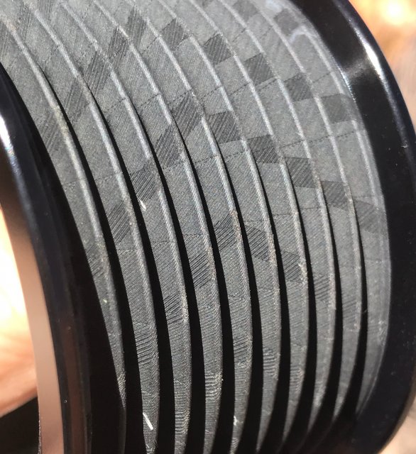

It has some friction grooves in it, but I'm told they wear down over time. Also, I'd avoid fixed pulleys personally and go with the Hellraiser design that decouples just like the stock pulley. Made by the same folks actually.

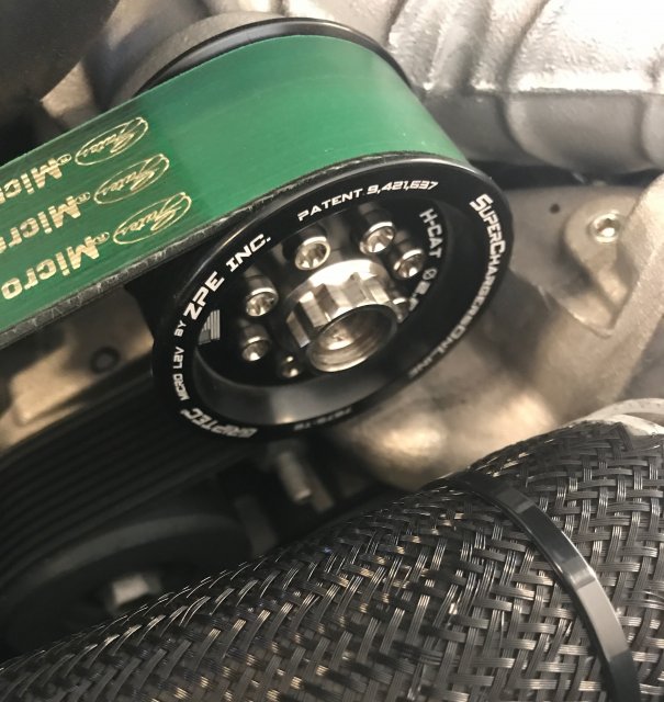

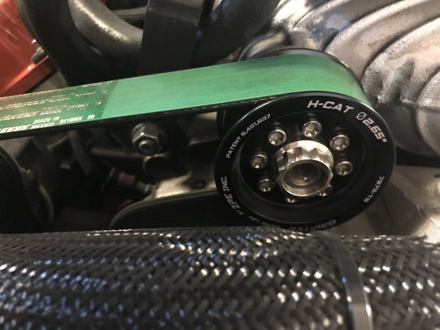

I was running 2.65 Griptec on my 900 whp Challenger and wondered why anybody would use anything else. Every Metco pulleyed car I ever rode in had belt squeak. Very annoying. I was running that 2.65 with a +10 ATI and never had any slip, dust or noise. In other words... it didn’t slip. And that was just using the stock tensioner without a additional idler to increase belt wrap. The surface may wear down over time but I didn’t experience that due to not putting a lot of miles on the car. As far as the quality of the hub and pulley combination.... there is nothing better. 5A442F77-81BA-485F-9CC0-29E75E2F92AB.jpeg EB14C23D-38D8-4CC5-B84B-9415534E21AF.jpeg B6E57FD5-1419-4922-91BD-BE85CEA79FAC.jpeg

I agree, I had a Griptec 2.31 upper on my 17 ZL1, no issues at all.

My son tried a grip tech on his procharged jeep grand Cherokee srt with a 426 hemi. On that application it ate through the belt so quickly he took it off after a couple of hundred miles. There was belt dust all over the front of the motor

Do you run this setup with E85?
