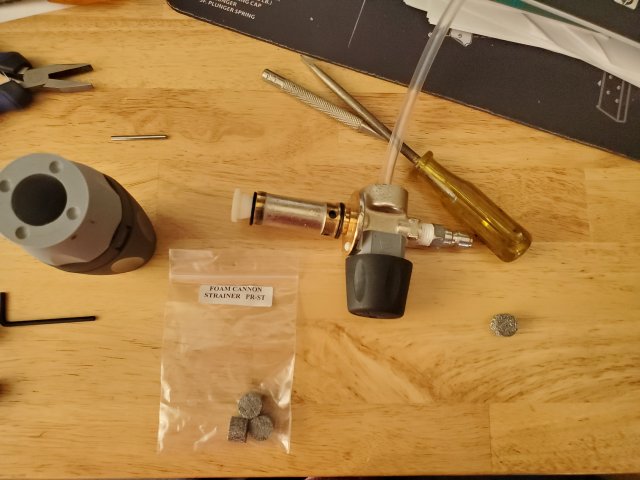

Thread Starter #24
Changing out foam agitator now...will report back once I confirm it fixed it.
What is that, some type of stone like those aquarium air stones?
Looks like maybe some routine CLR or de-scaler needed to dissolve hard water deposits, if your water has a lot dissolved minerals in it?

Thread Starter #31
It is a mesh filter. Could be when I rinse non DI water to clean it before putting away?

Washed a car just now...Foam Cannon back to running like new.
Good observation about the rinse. I'll have to use my DI when rinsing the unit.

Thread Starter #37
Glad to hear it's up and running again.
Only thing I can think of...fill a little DI in a bucket for rinse spray with pressure washer? Or, those mesh filters just get plugged overtime? Had this foam cannon over a year or so and do use a lot so maybe just a wear item? Hope this can help someone diagnose.
