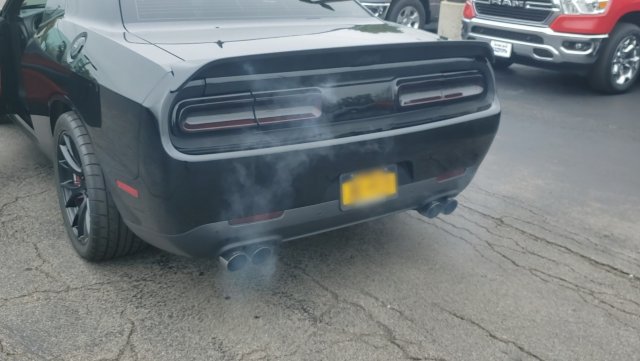

Question for those that had this V86 recall done -> When you picked up from Dodge was the car smoking very bad from the exhaust/rear of engine? Smelled like burning on the 15 mile drive home.
When I got back the exhaust wasn't smoking as much but still coming from engine bay. Terrible smell. White smoke.

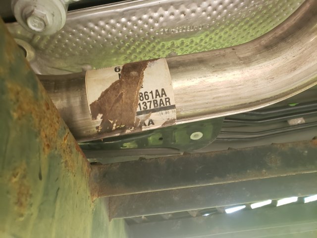

Pretty sure that is the new cats burning in (the smell). Mine did smell for a bit, maybe just the first few days of driving. Don't know if mine smoked, never noticed.

I did not look at the exhaust, but if it was smoking like that I'm pretty sure I'd have noticed.
There was no smoke from under the hood or any strange smells.

Mine didn't smoke, but did smell for a little bit

I had mine done a few weeks ago. There was a smell for the first few days which they warned me about. The one thing I did notice was they had left the large paper part number ID labels on them. The exhaust tips were also uneven, so while I had it on the lift I removed the labels to keep them from burning up. Perhaps its the labels burning you’re smelling?

While loading the car onto a flat bed today took a look underneath.
Burning smell/smoke was from stickers left on i believe. The ones on the downpipes burnt off, some ash residue left. Two still partially on the mid section.
Makes me feel a bit better, off to get the build finished.
