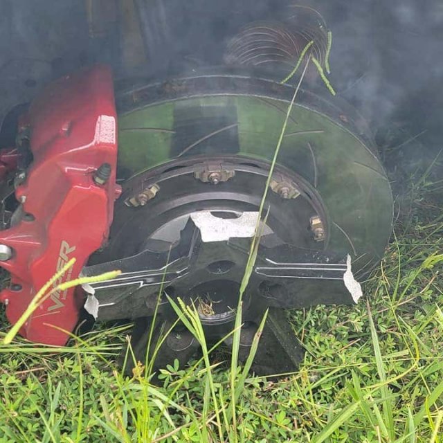

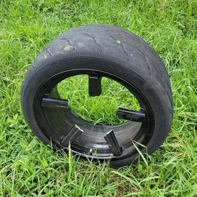

Saved these pics off the interweb a while back. As I recall this was on a Charger.
20,161
#70
After market and road course, if I remember correctly. Nasty.

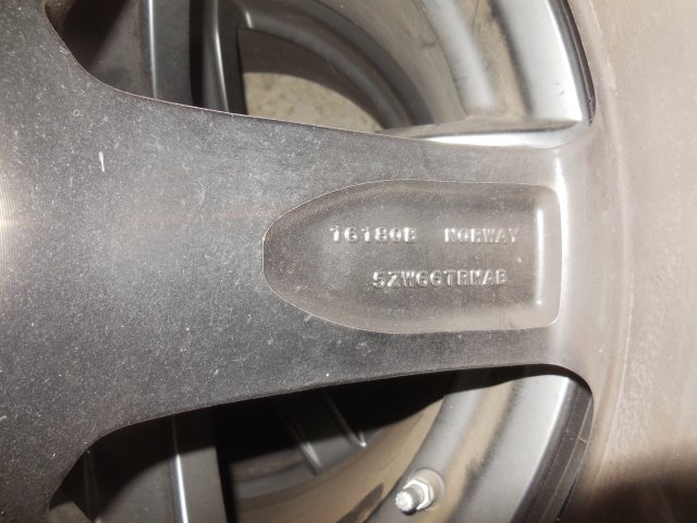

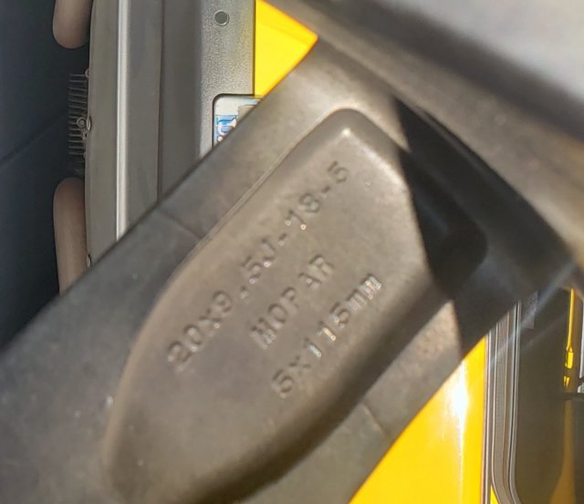

Thread Starter #71
These are the stampings from the wheels i bought off this site, to replace current fronts, including the fractured one. Same stamps on wheels on the car when I bought it. So, I think this is failure of factory wheel. What a drag... 20220107_152420.jpg 20220107_152504.jpg

#72
The norwegians are guilty!

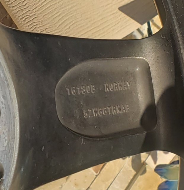

#73
Well, this is not good. You made me go look, only to see this on my OE wheels.
I don't want neither nor wegian wheels. Oh well, at least mine aren't black. DSCN4226[1].JPG

#75
Those are correct.
This is the first I’ve heard of this on OEM Hellcat wheels. I’m sure it happens and unfortunately it happened to you but based on the lack of griping about it, it sounds like an anomaly.
