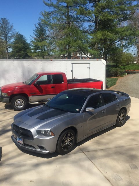

Silver Billet, I see it says you sold the Charger??? Did you get something else??
3,949
13,800
2021 Jeep GC 5.7 TrailHawk
No. Sold my Daytona too ( my new golf cart cost more than I got for my Daytona:oops:). Just part of our downsizing before we move permanently to our other home in Florida next Fall. Keeping my Barracuda for now but not real attached to it either. I’d really like to get a Charger Redeye but the Barracuda would have to go. I have options. I’m just going to have room for one toy, a daily driver and two golf carts. Once we move, the 2001 CTD and 24’ trailer will also be sold.
