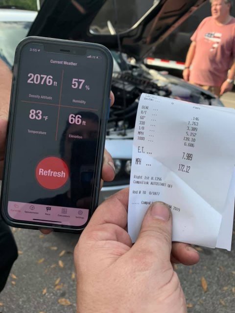

I think AJ's testing is officially going well
7.98 @ 172 yesterday. Video is on facebook
Yes, that was with Nitrous
