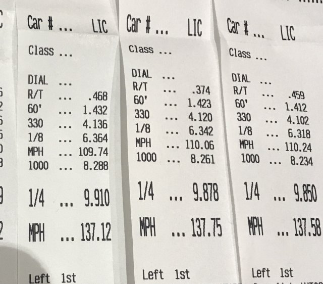

Here are some high 9 sec times slips. This will give you a look at the mph necessary to run high 9 sec et’s This was done on a well prepped track and I was running 3.09 gears with the 17” 315’s at that time. DA777280-DB3B-4999-A3A7-5185E05B6DD2.jpeg

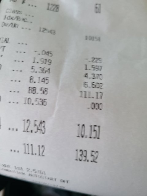

I know i need to work on reaction time but from my understanding that doesnt effect my et or 60ft. Yea ure getting 1.4 60.ft. That's where i should be but cant seem to get it there thus the thread.

Its decent. There's other cutting 1.4 and 1.3 60ft.
Hell less modified hellcats and scatpacks are getting out of the hole better than me. I just dont know what im doing wrong,
