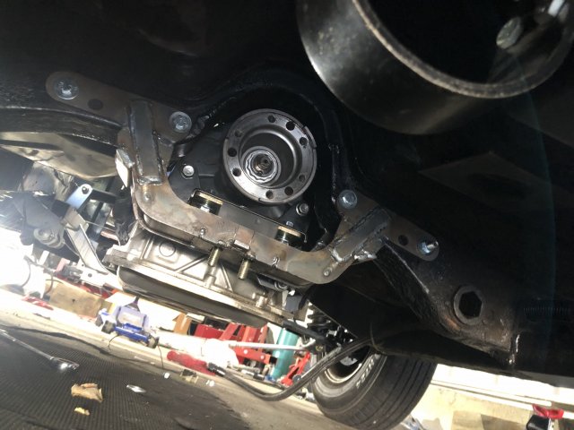

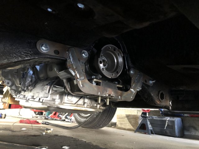

Magnified, used to be a mechanic and then worked for a speed shop many years ago when i was working my way through college. That's where I picked up MIG/TIG welding and some fabrication "skills" (if you want to call them that lol). Just been a hobby aside from doing side jobs for friends/coworkers though for the past decade.

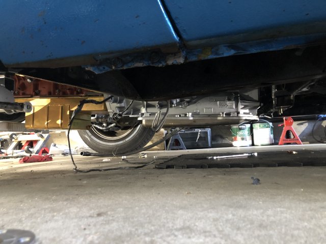

Pics are without the shims in the crossmember so the trans will come up a bit more and level out the engine. Not really happy with my work, welds and work was rushed and sloppy but definitely structural. Tough doing all this in a cramped 1 car and in a rush after working an overnight shift at work LOL. I mean hell, would have loved to TIG weld it even but this build really needs to be running by fall and there's so much more to do. IMG_9519.PNG

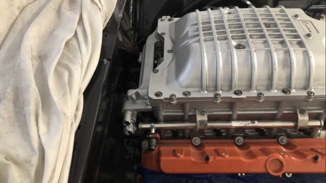

I'd say 1% chance on pulley failure at 15k miles. Just saw grease in the original pics so wanted to mention to check it.

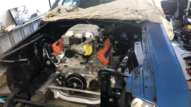

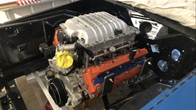

Not sure if this is allowed here, but I'm dropping a 15k mile 2018 6.2 Hellcat and 8hp90 into my 70 challenger and figured it might be cool to share. Obviously a lot of the swap stuff doesn't really concern most here who have actual hellcats, but figured I'd share some of the things that might be helpful (motor specific stuff).
I just finished up swapping an MMX NSR HC1+ cam and doing an ATI lower pulley. Going to share a few tips because I found there was A LOT of bad info out there with these mopars. I come from the LSX world and it's much easier to find accurate information, but these cars seem to have a host of people making youtube videos who act like they know what they're doing but push some false info.
