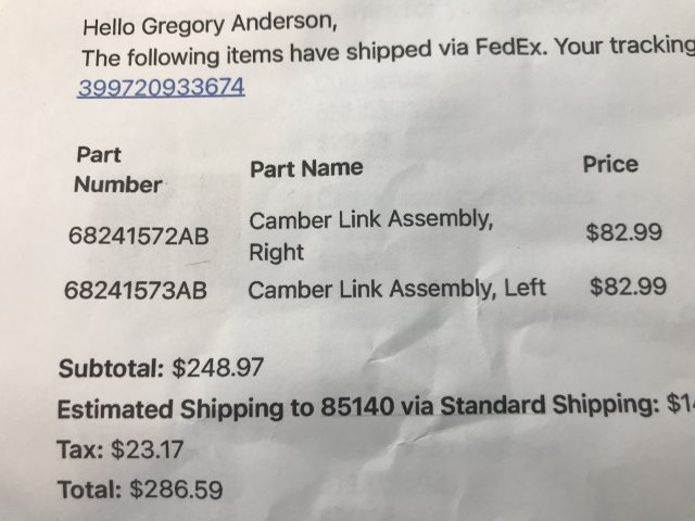

If most of you are like me you have a rear wheel camber out of tolerance on your Challenger.
I first encountered this problem on my 2008 SRT Challenger and the problem was there when I sold the car after 11 years.
I ran into the same issue with my 2015 Hellcat and 2019 Redeye.
The past several months I’ve been working with the new suspension technician at my dealership. Vince has been working on Mopar’s for 45 years. He did some research and found Mopar parts that we hoped would correct the camber issue. I didn’t want to say anything until we got the parts installed and verified with a four wheel alignment check. We completed that today and my out of tolerance rear wheel camber is now a thing of the past. Below are the parts if you interested. I got mine from Steve White Auto Parts.

What's different with those camber link assemblies? Those part numbers come back to what fit's our Hellcats..

No you can not. Put it on the machine and you will see.
They add plus 1 degree of camber.

Ok when I plug in my 2018 Hellcat for a replacement camber link on the Dodge parts finder it comes back with those part numbers you posted. I assume that means those part numbers are what's on my car stock.
They are not, trust me. The PN provided is a maintenance (camber) correction PN.

Your right and I stand corrected.
"Repair Link Plus 1mm"

If you change the length of the camber link wouldn't you need to change the upper control arm( front arm) the same length??

I would also wonder how we know 1mm is the right amount. Back when I did the Eibach springs on Orange Krush, the camber was a bit out of spec. The solution back then was offset camber bushings. They used to be pricey but I think they're cheaper now. I have a set on the shelf I never installed if anyone needs some, I can check the P/N. The boxes say Eibach, but I think they're Moog parts?
Honestly if you're bone stock and out of spec, I'd make it Dodge's problem to resolve.
You know the answer. It’s called engineering. Yes my numbers with new arms are almost identical to yours after alignment and for hundreds of dollars less. :)
No you do not.

I'm not trying to insult the solution. If someone has a stock car, has a camber issue, and wants to remain stock it makes sense I reckon. I'd make Dodge cover it if it's out of spec and can't be corrected though and hope the 1mm adjustment works for every case since it's set and not adjustable.
6,774
43,069
Speedy has much different bushings on those arms now. Yes, the static camber and toe are set, and match. So do mine. But, with the more stiff bushings etc, Speedy and others like me really like how those static settings are maintained under the stress. In his case many maximum straight line acceleration passes, timed critically to the tenth of a second. In my case under maximum lateral acceleration along with maximum acceleration only not from a stop, again those settings need to hold. The squishy OE bushings flex and allow those desired angles to change. Not good. I guess I won’t comment on the axial strength of any of those arms. Many times I have wondered if a guy could save about $500 and just change all the bushings. But then the cost of labor, looks, convenience, maybe I want to “tweak it” myself all factor in. Plus, I’ll take the arms with those Spheriflex Bushings in all the places he can put them.
