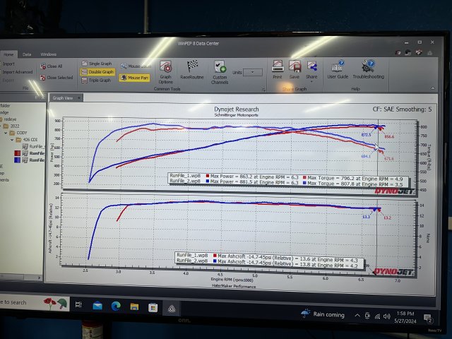

Enjoyed getting to see @Jon-MooredPerformanceLLC and Jim @Hatermkr work together to dial my car in today on Jim’s dyno. Both awesome guys who have gone above and beyond to right the wrongs of the last 8 months and I cannot thank them enough.
We ended up making 882WHP and 808TQ on 100 octane with a 2.85 pulley and 863WHP on 93. These were all done in 5th gear so probably pretty close to 900 if done in 6th, which would be 1:1.
Full build list for this 100% built Schmittinger Motorsports 426:
6.2 BGE SRT block
CamMotion big cam (Jon Moored custom grind)
ID 1050x injectors
Thytek Ported and Polished heads (Brand new titanium springs, guides and inconel valves)
Harden rocker shafts, rocker stabilizers and rocker studs
Callis 8 counter weight billet crank
Oliver billet rods
Diamond pistons - bored to fit
ATI front balancer with keyway
Heavy Duty piston pins
Moral lifters
New timing components
New oil pump
New Oil Cooler
ARP hardware holding it all together
Other:
Fi Interchillers Stage 2 Interchiller w/ 4 gallon capacity coolant tank
Stainless Works long tube headers w/ high flow GESi cats w/ custom inconel heat shielding by ATP
FI Interchiller 1" blower spacers and blanket
Overall, I’m extremely happy and excited not only to get this car back but also to enjoy what surely is a one off performance build. I effectively have Demon 170 power but achieved mostly through displacement with a much lower amount of boost. Should lead to a long happy life for this motor.
